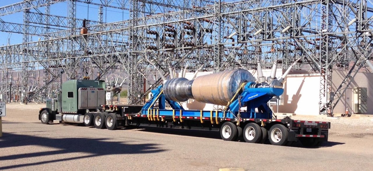

    Thats a beautiful set up and love the pic.
    How much can you scale with that set up?
