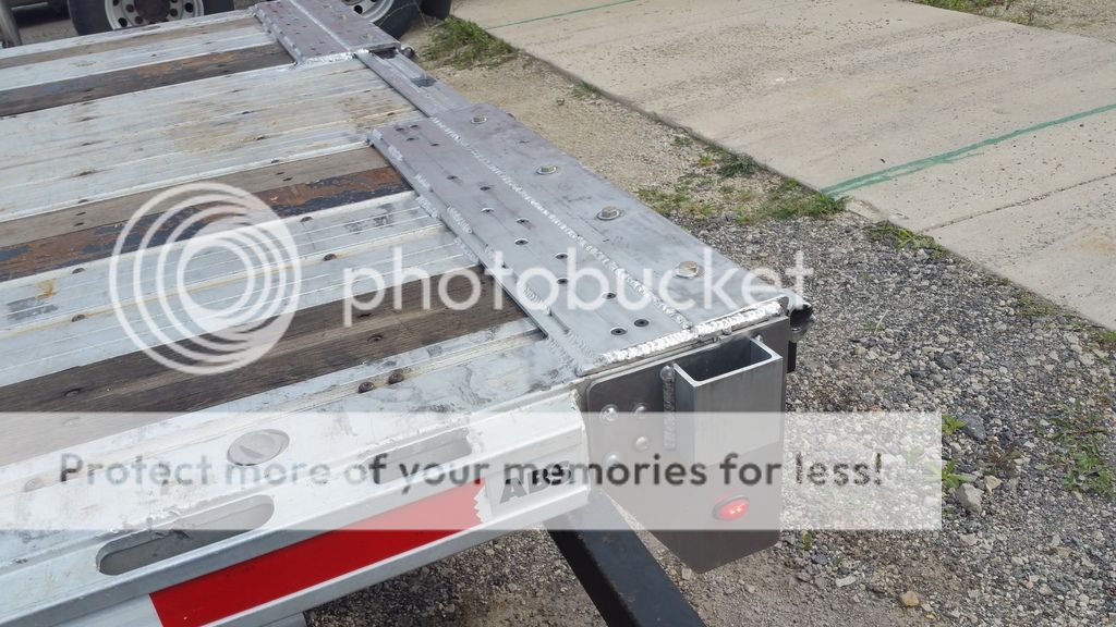

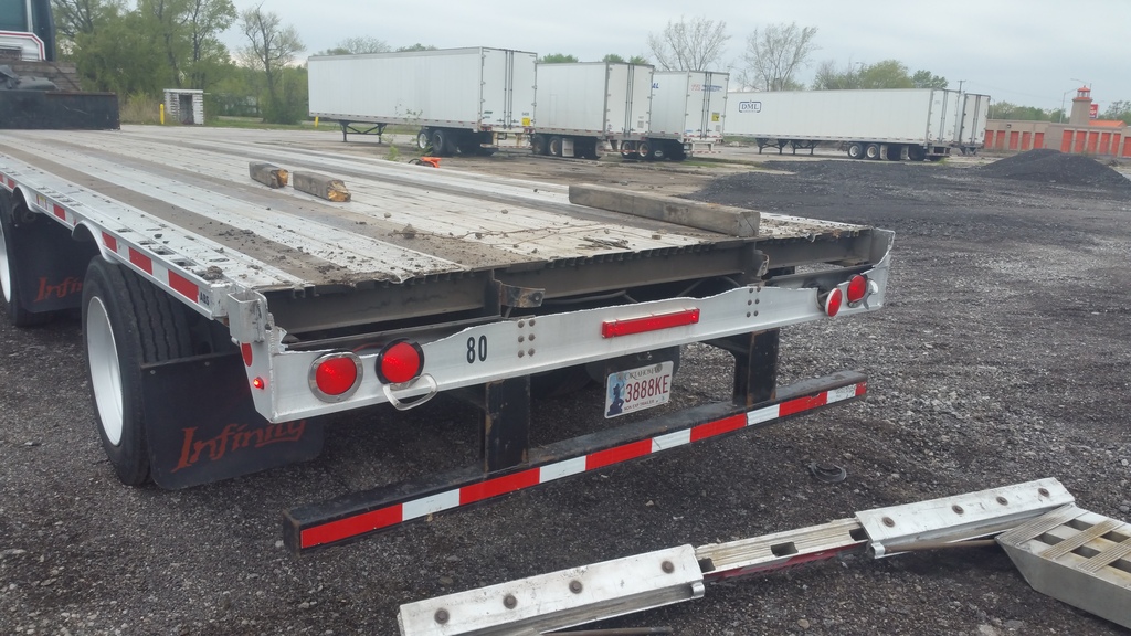

    The HD ramps are rated for 47,000lbs. The heaviest I will personally load up on them is 42,000 - 43,000 lbs for tracked machines. I have 15 yrs of experience operating various machines for site development. So loading and unloading these machines comes naturally to me. I do not recommend you go for something that heavy with out some sort of comfort level with the machine you are loading. Do not trust shippers to load up the ramps for you. As @johndeere4020 will be quick to point out from a post I made a while back. There is a level of risk involved when loading heavy up ramps onto an aluminum deck.
    I'll do the honors this time.
    My carrier has a guy that we haul a lot of equipment for. Usually no one is there and I pick it up and load it myself. This particular time the owner was there and he wanted to load the machine himself. What happened was that as he approached the top of the ramps where the machine starts to tip he panic and became unsure. All of the machines weight (42k lbs) was on teetering on the edge of my trailer. I was yelling at him to continue forward and let the tracks land on my my deck. He kept inching left and right,.. not sure of his bearings. This was too much for my trailer to handle and the results are in the pics above. The ramps did not fail here. My trailer failed. When loading machines with this much weight,.. dozers, loaders, excavators,.. its best to use a loading dock,.. or if you bring them up the ramps,.. you need to have it lined up from the start,.. once you start tipping,.. you can not stop,.. it must land on the deck.
    My trailer has since been repaired and during the repair process I had them do some custom reinforcing underneath as well as on top. In theory,.. it should be able to handle a 42k lb machine teetering on the edge,.. but I am not willing to test it. :)

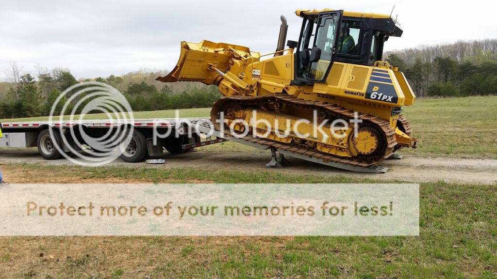

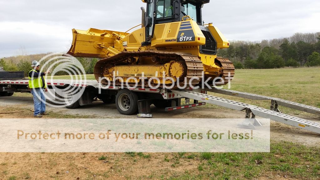

    Here is a really good series of pics showing a 41k lb D61 coming off my deck and down the ramps. This should illustrate everything you want to see of how the trailer reacts to the weight during delivery or while being loaded. This was also well before the reinforcements were made,.. this was as you would buy from Fontaine.
    This is where I loaded it.
    And here is where I unloaded it.
    Ta da,.. and there you have it. I hope that helps.
