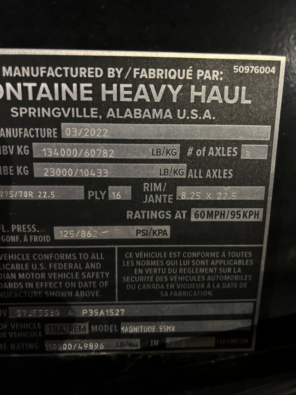

  5. Rontonio
    Rontonio Road Train Member
    6,547
    48,596
    Aug 9, 2009
    This is the tag n my 55 ton trailer
    134k is not what it is rated for

  9. Rontonio
    6,547
    48,596
    Aug 9, 2009
    yes it would but I think that it means the actual capacity is under 100k as a bare 3 axle (given an actual empty weight of near 28k). To actually see the full 110k a 4th axle would be necessary. This doesn’t change the rated capacity on the bottom of the tag at 110k in 16’ closed and 1110k in 50’ 2 point loaded 1’ from both ends.
    What I was trying to get at for the OP is the GVW on the tag and the actual weight rating published by the manufacturer are different concepts.
