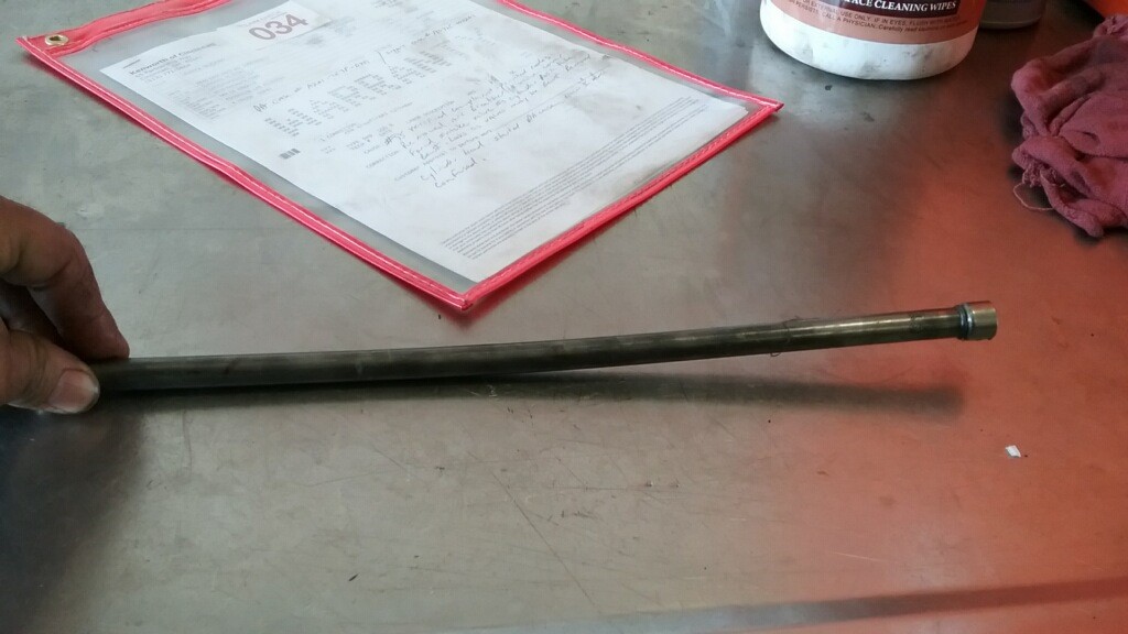

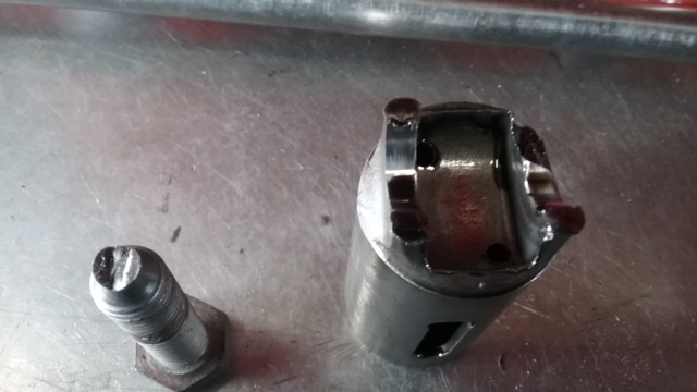

    Have a truck down for three weeks with same issue right now. Covered under warranty. Truck has 240,965 miles. No overspeeds logged. Overehead set @ dealer @ 40,000 miles. Getting new cam and ALL rollers. Here is some pics for you @daf105paccar . Broken lifter.jpg bent pushrod.jpg

  8. Oldironfan
    Oldironfan Road Train Member
    5,776
    5,541
    May 22, 2017
    Was this regular use? Seems like a quality control issue? Or just maybe Wigner effect?
  9. spsauerland
    spsauerland Road Train Member
    4,296
    10,891
    May 31, 2010
    West Harrison, In
    Normal use. 2016 T880 pulls a blow can hauling mostly cement. MX 455 with Ultrashift plus. 20,000 mile oil changes with oil analysis every time. Genuine Paccar filters. Oil is Connoco Phillips 76 Guardol ECT 15W-40. First iron issue we have had with MX. Have 29 of them and this is one of the lower mileage ones. #### happens???

  10. daf105paccar
    6,564
    7,293
    Apr 15, 2012
    Every engine has something ,some part where it is at it weakest.
    With the MX 13 i would say that is it.
    But Volvo's can have a similiar issue(the "little wheel" on the cam can seize)
    Is rare but it happens.
    Aldough here Paccar is quite good about it.
    @spsauerland any damage to the block?
    Ps the MX11 has a completely different design.

  11. spsauerland
    4,296
    10,891
    May 31, 2010
    West Harrison, In
    Bore for lifter was scratched/scored, but I was told it cleaned up fine with a hone. Doesn't seem to be a common issue like like Mack Etech Cam rollers or rollers in Cummins ISX fuel pumps. Crappy part is if cam has to come out, engine has to come out.
