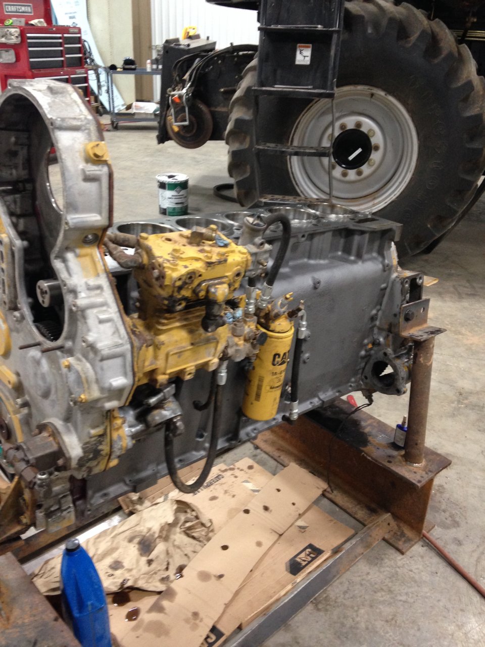

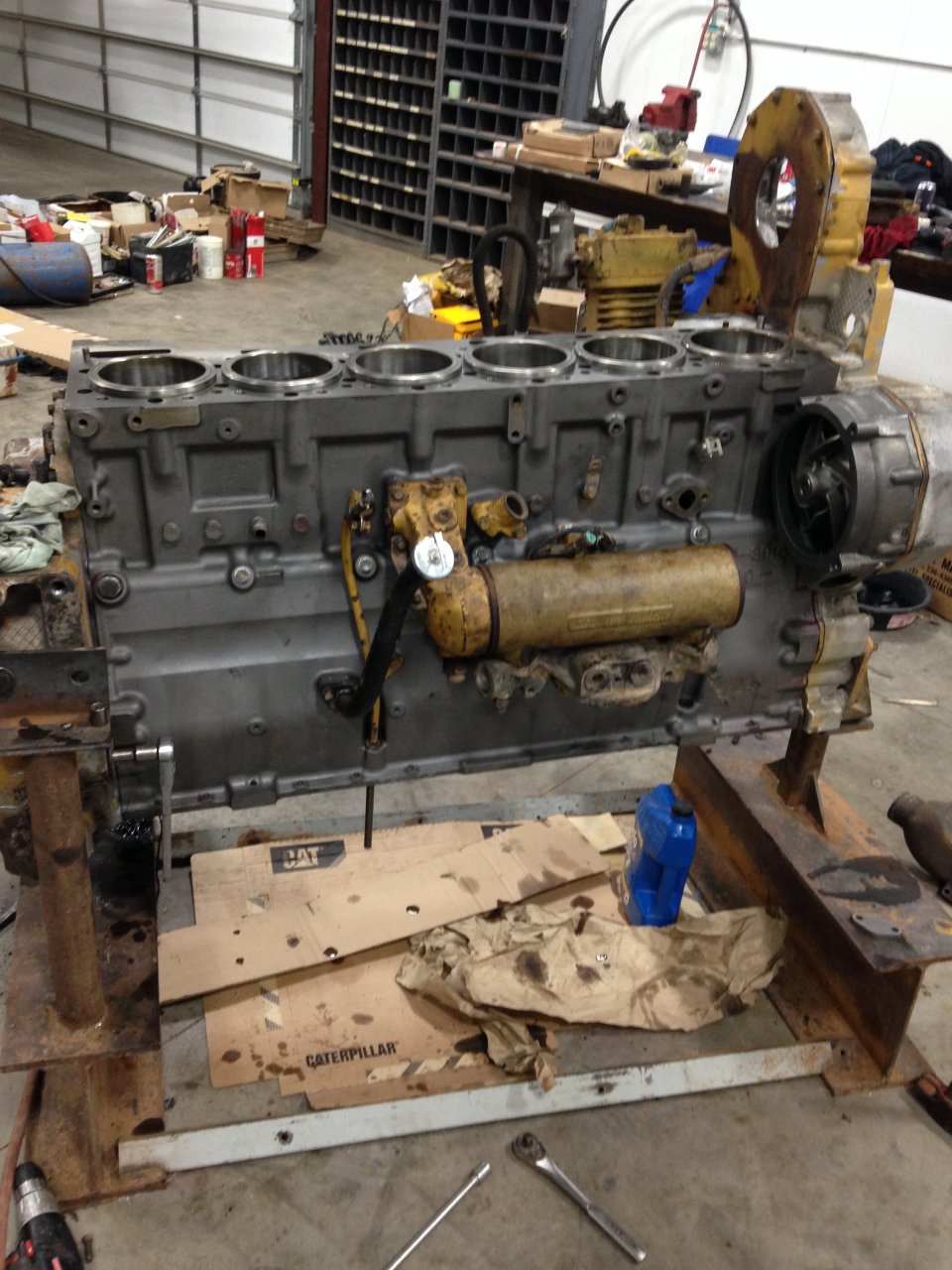

    image.jpeg image.jpeg Pistons are in and everything is torqued on the bottom side. I plan on getting the head put on and oil pump and pan later tonight

  9. Superhauler
    Superhauler TEACHER OF MEN
    12,209
    100,735
    Jan 30, 2010
    keep stroking.
    You are going to check liner protrution, right?

  10. Diesel Dave
    9,733
    33,336
    Jan 20, 2010
    Hesperia, Ca.
    Times 2, you beat me to it.
  11. Superhauler
    12,209
    100,735
    Jan 30, 2010
    keep stroking.
    Hey @Tmtbob if they did it right and everthing true. With the thick spacerplate you will be at .003 and .006 with the thinner plate. If you opt for .006 use an anarobic sealant on the tin gasket along the edge all the way around. Yeah i know they say to not put anything on the tin gasket. But cat actually sells the sealant for doing just that. If you don't and there is the slightest unevenness on the block deck or spacerplate or head you will have seapage.
