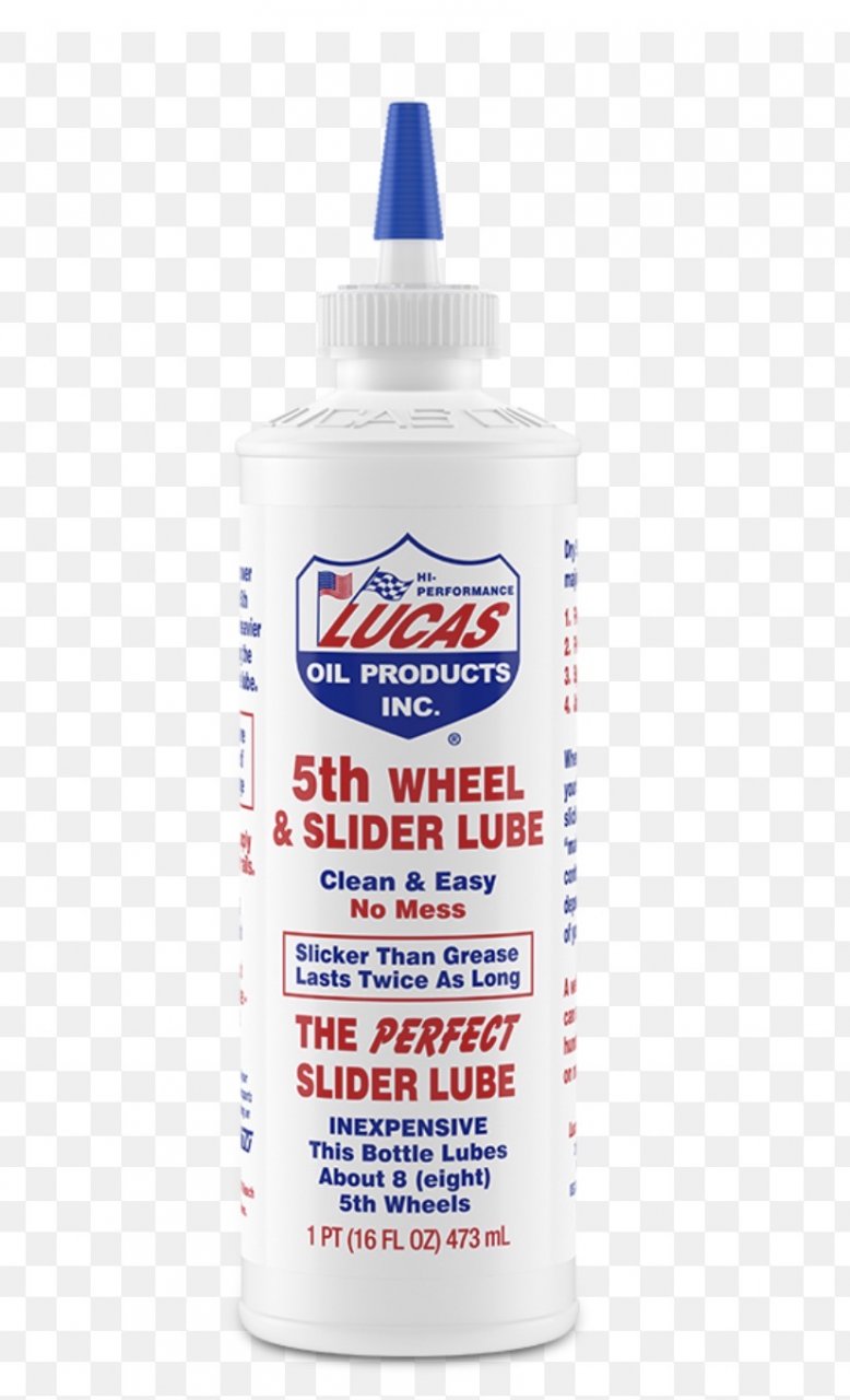

    I buy this by the case of 12 on eBay. Keep one in the truck. Yea, could be stringy in the winter, but it works for me. IMG_7978.jpeg
    Siinman, Lonesome, lual and 4 others Thank this.
