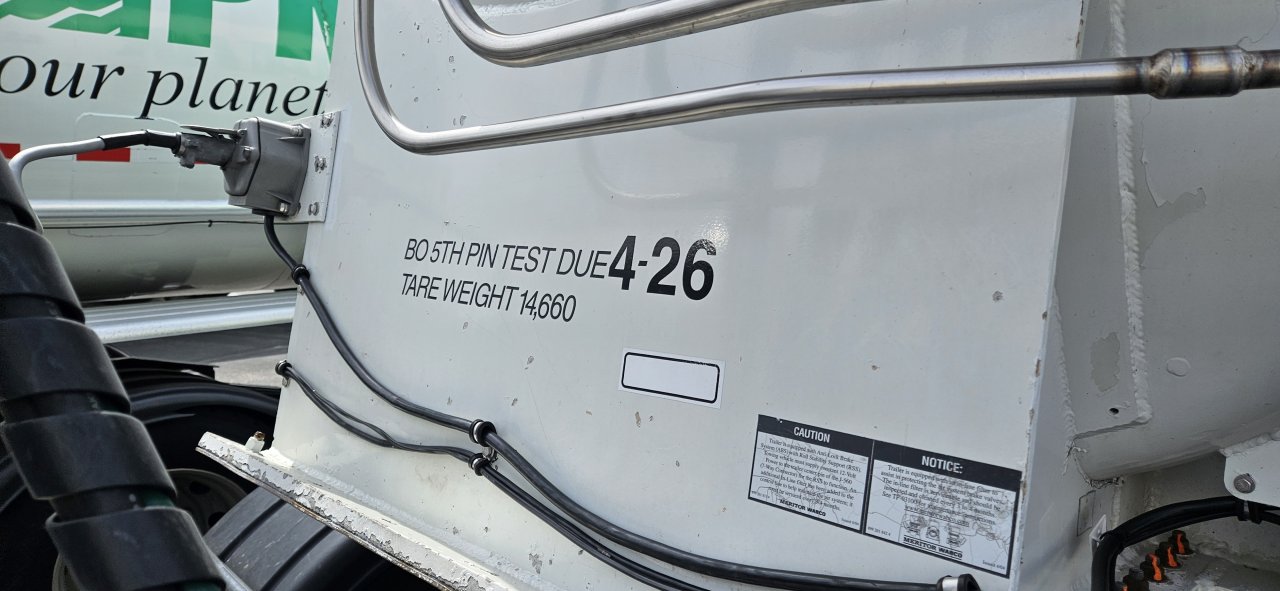

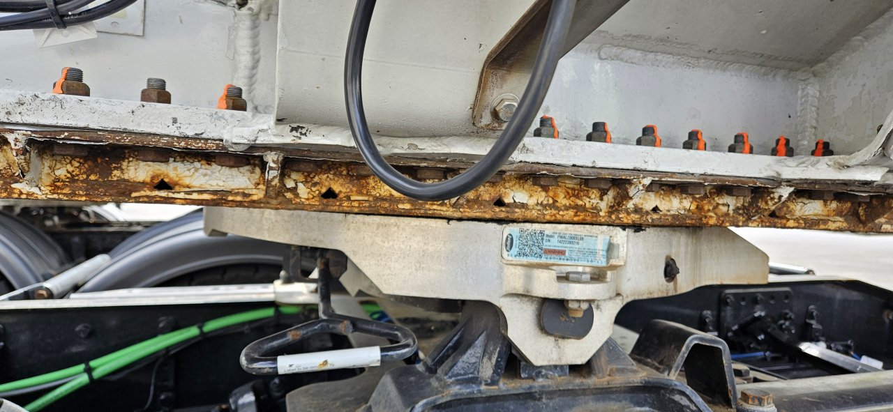

    Not a problem. Those are just paint cracks and rust.
    Each unit has the king pin plate removed and inspected per federal requirements and that one was probably due soon.

  4. MACK E-6
    50,139
    239,521
    I recall a post by @gentleroger about an issue similar to this. OP’s issue sounds like the jaws broke, but the scenario Roger mentioned had something to do with rust making the jaws stick and not engage completely, with left turns causing the rotation of the kingpin to push them apart.

  6. gentleroger
    gentleroger Road Train Member
    7,942
    21,748
    Jun 1, 2010
    Not rust, excess grease on the locking mechanism making the jaws come across slowly and either get blocked by the kingpin or just not have enough force to get locked. Excess grease is the major culprit of most of our "my 5th wheel won't lock" road calls.
    In this case it sounds more like internal failure of the 5th wheel. It happens, not commonly, and usually will get caught at a PM long before it fails under a load. Most of our 'unplanned disconects' happen because the driver had a bad hook and just didn't realize it. One guy got hooked, slid his tandems with undue force, then made three left hand turns to head to the shipping office, then a left hand uturn, and finally dropped the trailer as he made the first right hand turn. I pulled a softball sized wad of grease out of his 5th wheel. Another guy made it two blocks before he dropped it. Neither of them were in the habit of using a flashlight to check the connection.

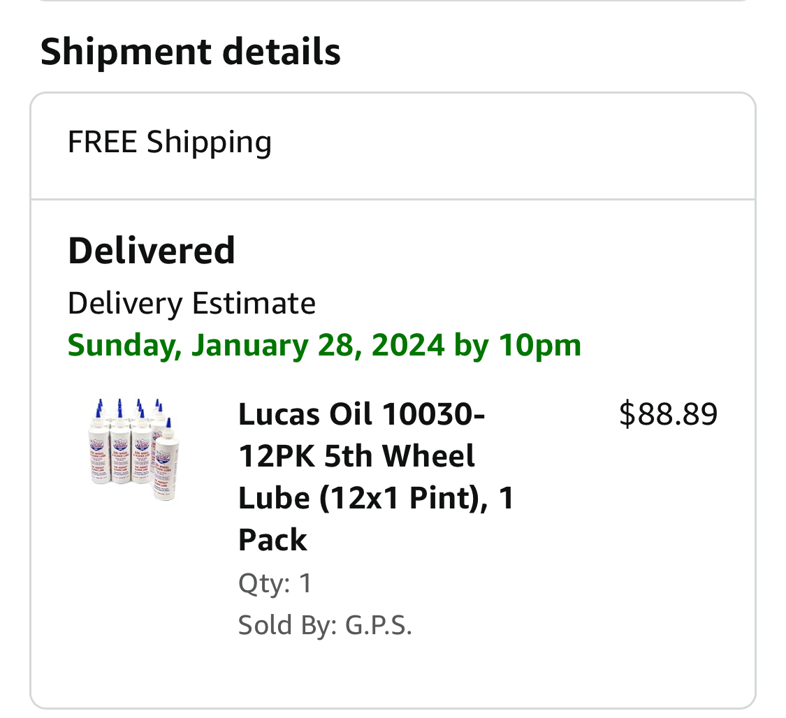

    I buy mine by the case of 12 on Amazon. Comes out to $7.41 a bottle.
