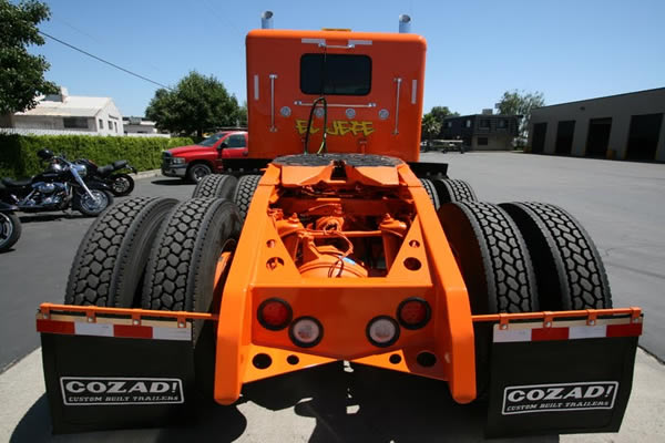

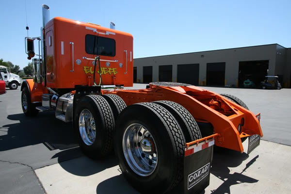

  8. Joe567708
    Joe567708 Bobtail Member
    36
    62
    Jun 5, 2021
    319D38FD-C940-4DB6-AFE2-F7AC19958B75.jpeg DC8AF064-9B09-4B62-8058-C2738DE574F9.jpeg
    Those are for big boys.
    I have a Toyota (volvo) truck. :)
    Stray_Dog, cke and nikmirbre Thank this.
  9. beastr123
    beastr123 Road Train Member
    2,952
    24,213
    Jan 2, 2014
    Moose Jaw SK CAN
    Remember to measure the height of the pickup rollers on the trailer you have access to dropped on level ground and consider having the ramps built to pick up 2 inches lower in case of uneven ground.
    I had mine built to be able to pick up trailers at 36 inches and never had any trouble even with extended neck 55t low-boys and more.
    The ramps you pictured may work for most 25t or 30t trailers but by the time you are looking at 40t or more you may have trouble getting under them.
  10. nikmirbre
    nikmirbre Road Train Member
    5,590
    10,358
    Jul 27, 2011
    High Point NC
    Yes call them. Make an appointment. They'll build you the best ramps and install them......Theyll build exactly what you need!
    cke and Joe567708 Thank this.
