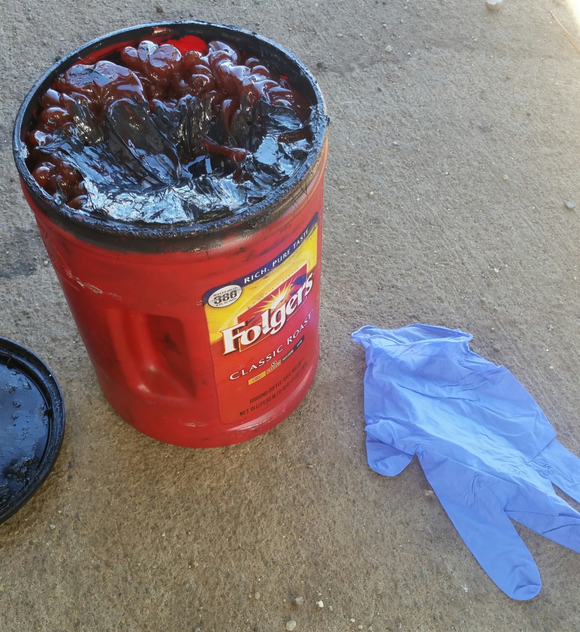

    Lol I was going to suggest super tech , but u can't beat free!!

    I agree this stuff works great and it last a good while.
