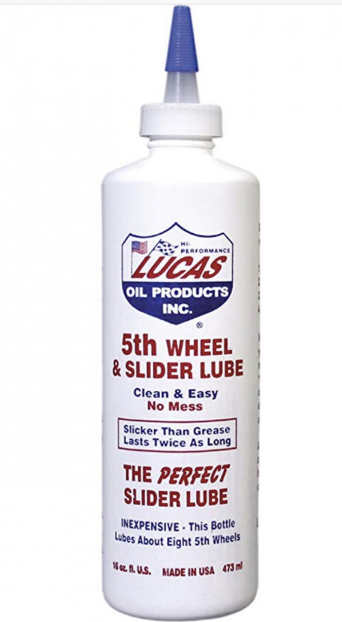

another good one.
Schaeffer Oil | Moly 5th Wheel Lube amazon has them. it's a spray.AlexR_uz Thanks this. -
That stuff is great.
Untill the bottle tips over and it leaks out someplace you don't want it. It will fight you for hours before it comes off.
Exelent for a fifth wheel, bad for a floor or side box.otterinthewater, magoo68, Rideandrepair and 1 other person Thank this. -
