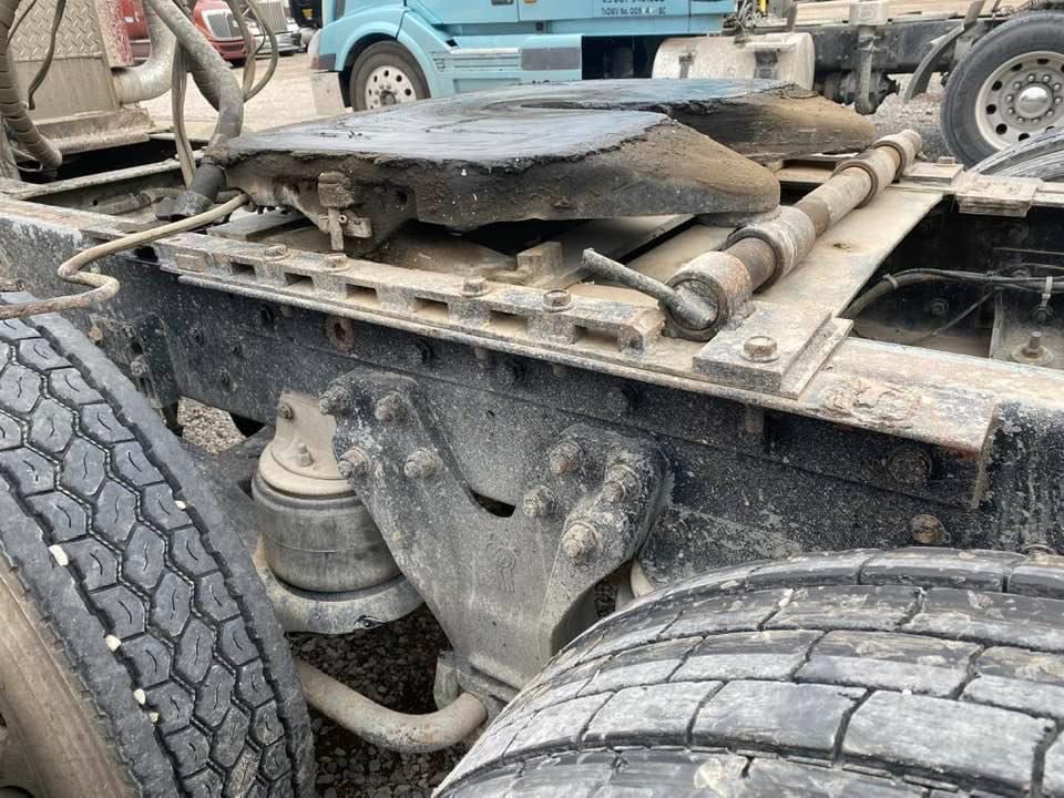

    I just bought an end dump trailer.
    I need a kit to pin my 5th Wheel since I have a frameless end dump. I can't seem to figure out which brand of 5th wheel that I have.
    Would anyone know bases off of a picture what brand I have?

  3. Arctic_fox
    4,617
    26,464
    Sep 16, 2016
    Looks like a fontaine 6000 same as mine. Just get a pin custom made. I couldnt find a kit that would fit mine at all and custom was the route i was forced to take.

  4. Ruben01
    Ruben01 Bobtail Member
    20
    9
    Feb 1, 2022
    Just weld a removable pin setup to the 5th wheel u already have

  5. Ruben01
    20
    9
    Feb 1, 2022
    Or u can weld bump stops but its not going to be removable like the pin

  6. Slowpoke KW
    Slowpoke KW Road Train Member
    1,170
    12,827
    Dec 7, 2015
    OK
    That looks like a Holland to me. Most folks just make their own or replace the entire thing with a blocked wheel

  7. Ruben01
    20
    9
    Feb 1, 2022
    I think fountain sells blocked fifth wheel if u want it new

  8. OldRed98
    OldRed98 Medium Load Member
    308
    251
    Apr 18, 2017
    Colorado
    Inland Truck parts says they sell a pin kit but we couldn't figure out what 5th wheel I have. The guy told me to go home and scrub all the grease off and try to find a marking on my fifth wheel.
    I'm hoping to get my trailer on the road without waiting too long for a kit to ship. Some online retailers are saying 10+ days before the parts even ship.
    Anyone have idea's on making a pin that I can weld on? I'm trying to think of parts I can get locally. I have a tig welder and could custom build something.
    I would need a removable pin VS a block because I still want to be able to haul a step deck. Thank you
  9. Ruben01
    20
    9
    Feb 1, 2022
    I can post pics tomorrow of the set up I have
    OldRed98 Thanks this.
  10. Ruben01
    20
    9
    Feb 1, 2022
    Thats the common removable pin setup used
  11. OldRed98
    308
    251
    Apr 18, 2017
    Colorado
    Thanks everyone. This helps.
    Some tube steel and just need to find a round bar somewhere.

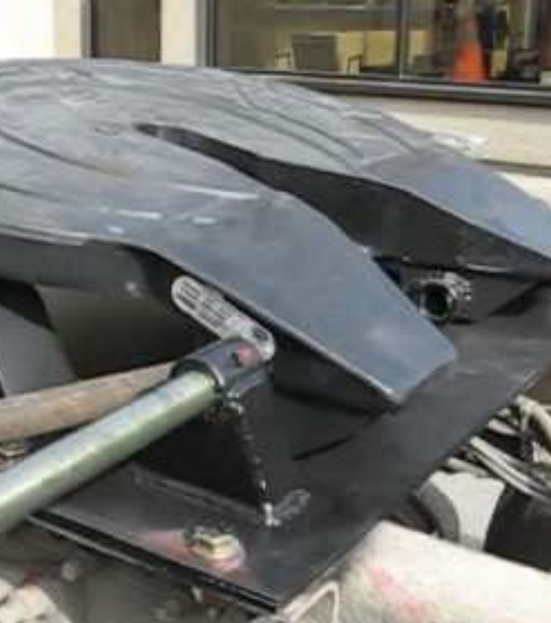

    Here was one I found online.
