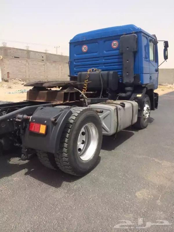

    This is my set up
    work as a substitute of double frame insert + a bridge

    Is it MAN F2000?

    Apr 20, 2013
    Yes Pablo. The best ever F2000 & Volvo F12
    They can take abuse for years
    here is a guy with 90 tons steel load( they make in one week more than I do in a month this way) And to avoid cops and scale station ,they go off road
