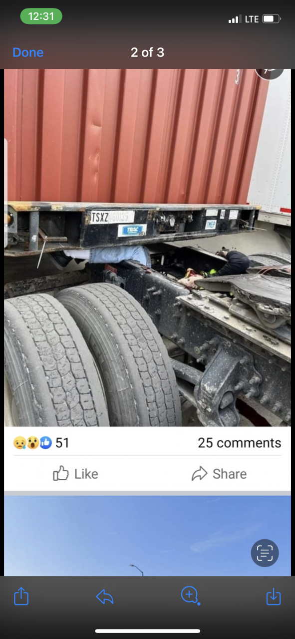

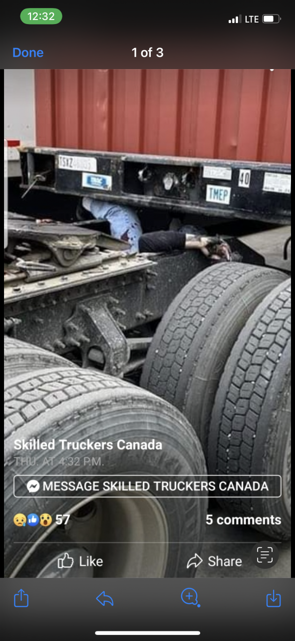

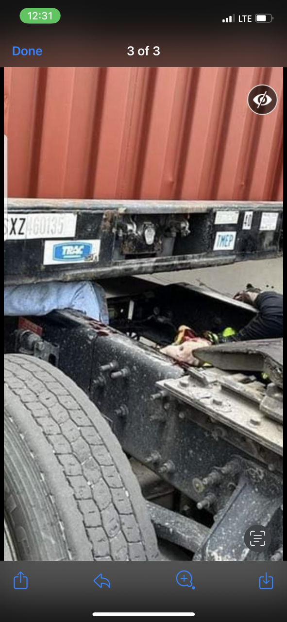

    Careful checking fifth wheel if you have a co driver 2088A042-806B-4C38-AB75-C069ECD45D0E.png C2347D46-88C7-4DDA-A200-D200C68D90F8.png 08574E98-403E-47FD-97EE-686909A4FDF1.png

    He was checking hoses or cord and co driver backed up. I can’t link story but his name was David Poe it pops up on Google without these pictures though. A friend sent them to me it happened at nky logistics

    That's a horrible way to go.

    David Poe, 58, of Independence, Kentucky, was working at GXO Logistics when the semi hit him around 3 p.m., according to Kenton County Police.
    The semi was backing up to a parked trailer at a loading dock when it hit Poe, police explained.
    The 58-year-old GXO Logistics employee died at the scene.
    Worker hit by semi at NKY logistics company dies
