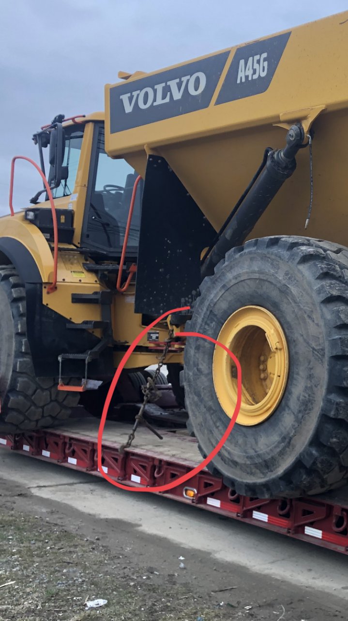

    This parked by me today, 65,000 lbs just had 4 half inch chains 2 on the front of the truck pulling to back,2 buy the rear wheels almost straight down. BB634466-5E83-498D-AA84-6D14B3DEA16E.jpeg

    Maybe gravity is much greater than 9.8 m/s squared on his route so those babies will hold her y not

    Where's it going to go? It's not like a load of sticks.

    Maybe he thought he was working by indirect securement rules and doubled it. Did you tell him you were calling DOT if he didn't fix it? I might have if it was 2 chains short of covered.

    It could slide off the side on a fast sharp corner, just hope it goes into the ditch, not on top of a car.
    He has the equivalent of two chains from side to side.
    And what does it matter if it goes in the ditch, it’s just a half million dollar truck.

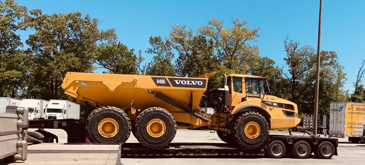

    IDK, I've hauled heavy machinery, and found steel tracks can slide, but anything on rubber usually stays put. Besides, where else are you going to put chains except front and back? Like with any machinery load, especially step deck,, you gotta be careful, but I'd probably run with this.

    I haul that exact truck all the time, it has tiedown points in the middle right behind the pivot. I put my front and back the same way but I put two on the middle pulling towards the front. E40B63D0-807C-4FBA-A2C8-F1282D9C2DCF.jpeg

    Thanks, but you know as well as I do, that little chain in the middle isn't going to do squat with a machine this size in an upset. For looks only. I'd probably put a chain in the middle, like you show, and I've hauled some pretty big loaders, not far, but never for a minute thought that chain in the middle would do any good.
