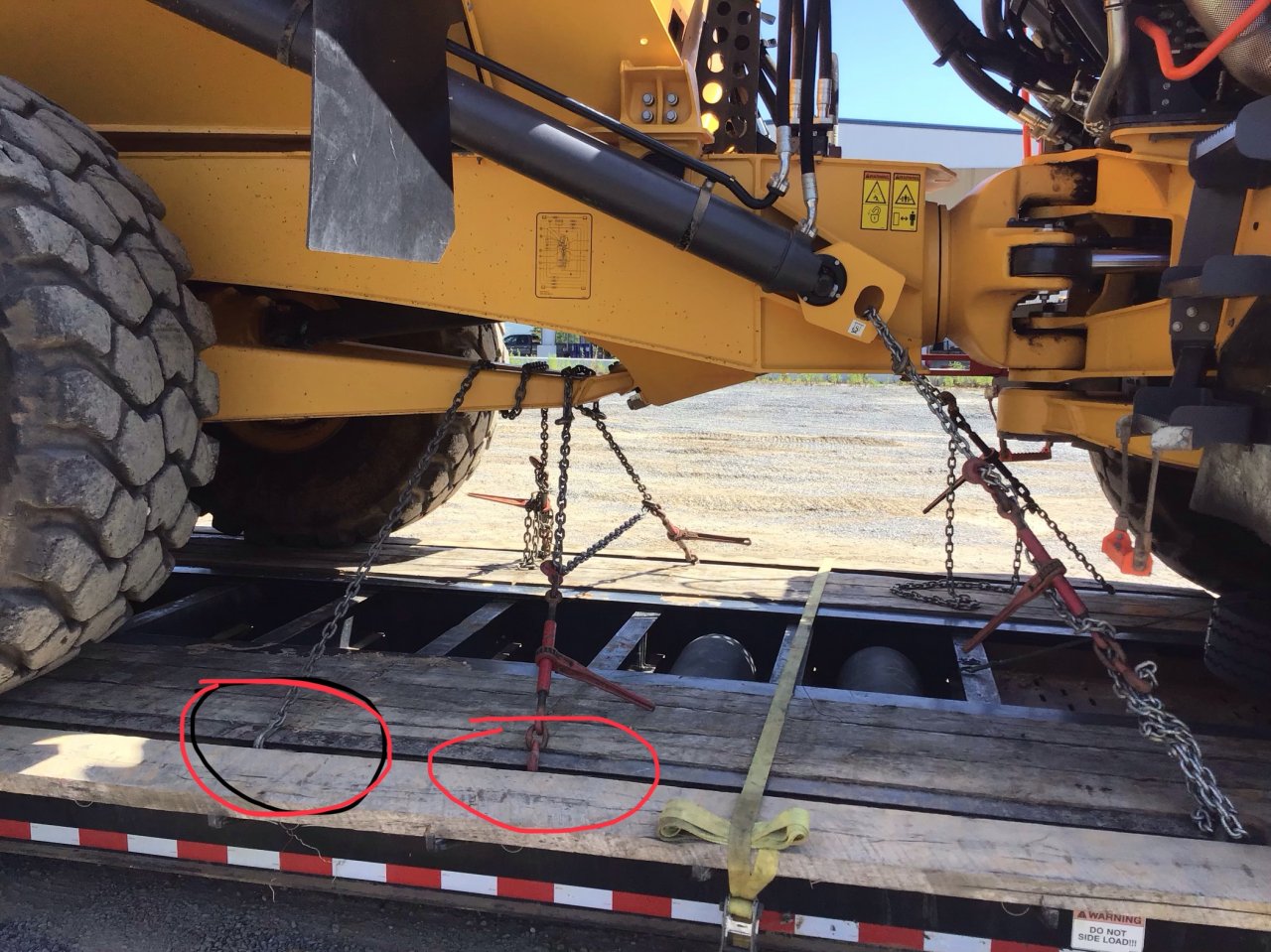

    D9752578-9E56-43C3-9132-E8D4001D02BE.jpeg I used my outrigger boards and couldn’t get all of my D rings flipped up. So I hooked to the upper flange a few places. What is the rule about doing this?

    I would just make sure it's hooked right against an outrigger hinge so it doesn't slide on the rail. But I'm more interested in wtf that rear chain is doing.

    I don't think I would've put a chain there in back. It can probably take the weight but looks iffy.
    I also use the flange but like has been said. Put the hook next to something to keep it from sliding.

    I wouldn’t have put the back chain there either. If for no other reason than it will chip the paint up on what looks like a new machine.

    In Wisconsin, it's legal to hook the rail with a binder...
    The back chain is a no go.
    Per our Volvo dealer ,only use the tie down lug. You can run 2 chains thru it on each side.

    The binder is fine. Cut your outrigger boards a couple of inches narrower and you won’t have that issue.

    65k machine
    He needs six 1/2 chains
    Four to the rear and two to the front.
    good luck on his trip hope he makes it safe
    1/2 chain is rated at 11,300 x 6 chains is 67,800 more then enough
