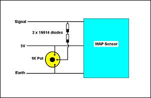

    Here it is, again.
    The circuit consists of two diodes and a 1 kilo-ohm pot. Its sensitivity can be adjusted by rotating the pot - this should be set so that the circuit clips at as high a manifold pressure as possible.

  11. Mr. Haney
    Mr. Haney Road Train Member
    2,693
    2,041
    Dec 17, 2008
    I've never worked with this set up or even heard of it before. I have a question. Will it allow the ECM to see the range of manifold pressure as it rises and falls, but just cancels the signal out at the higher setting of your choice? Not send a preset signal all the time to the ECM.
