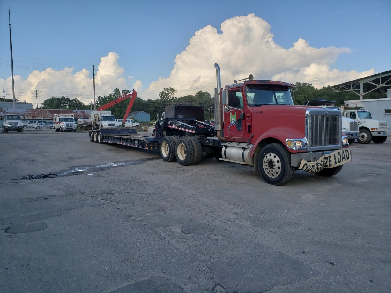

This is what I drive at work. '02 international 9900i 201" wheelbase with 52 foot globe 55 ton hydraulic RNG.
Tare weight 39,740lbs
DrDieselUSA and PoleCrusher Thank this. -
Your sign is hanging downSAR and PoleCrusher Thank this.
It's been pulled tight since then, of course working for a municipality we get away with a lot of stuff.PoleCrusher, stwik and Humblepie Thank this.
