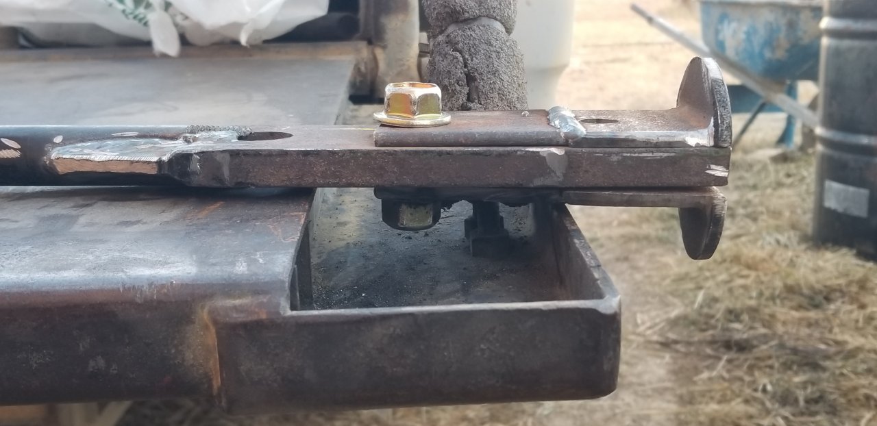

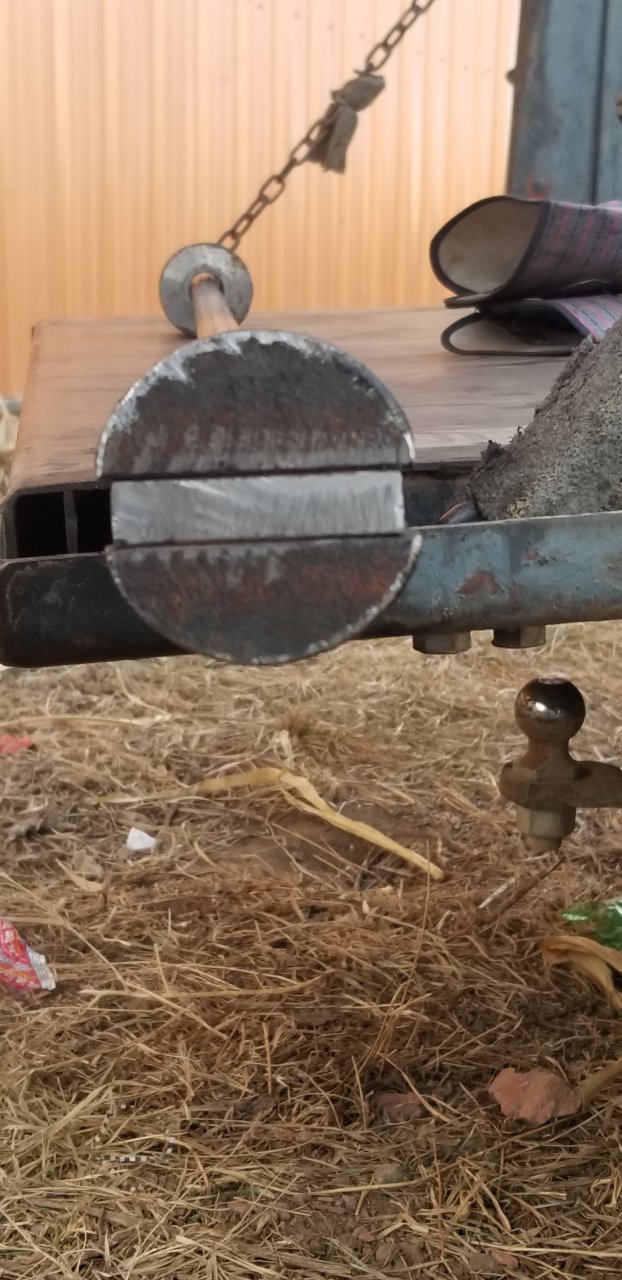

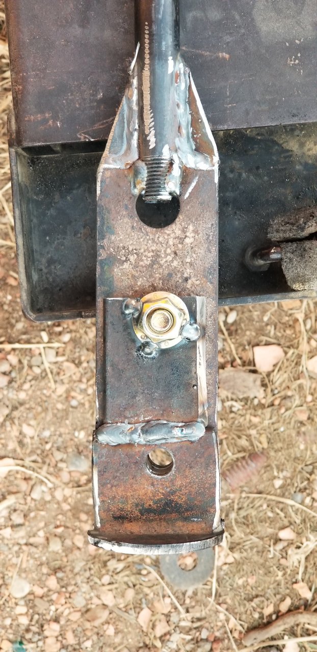

    First of all I owe this to BoxCarKidd on this forum who shared his idea with me. It took some cutting and grinding. Can be made with or without welding. I used it on a cummins n14. Photos attached.
    This is bolted together inside the engine behind the bearing you want to pull. 20201128_153634.jpg 20201128_153640.jpg

    A one time Cummins would come out and do work for others. Cut counter bores, replace cam bearings and or sleeve the block for a spun bearing. That type of help is long gone.
    I just try to figure out how to do what i can. Glad that worked out for you.

    Nut spot welded on is a good improvement.

    It was the only way really. One hand operation on an international 9400
