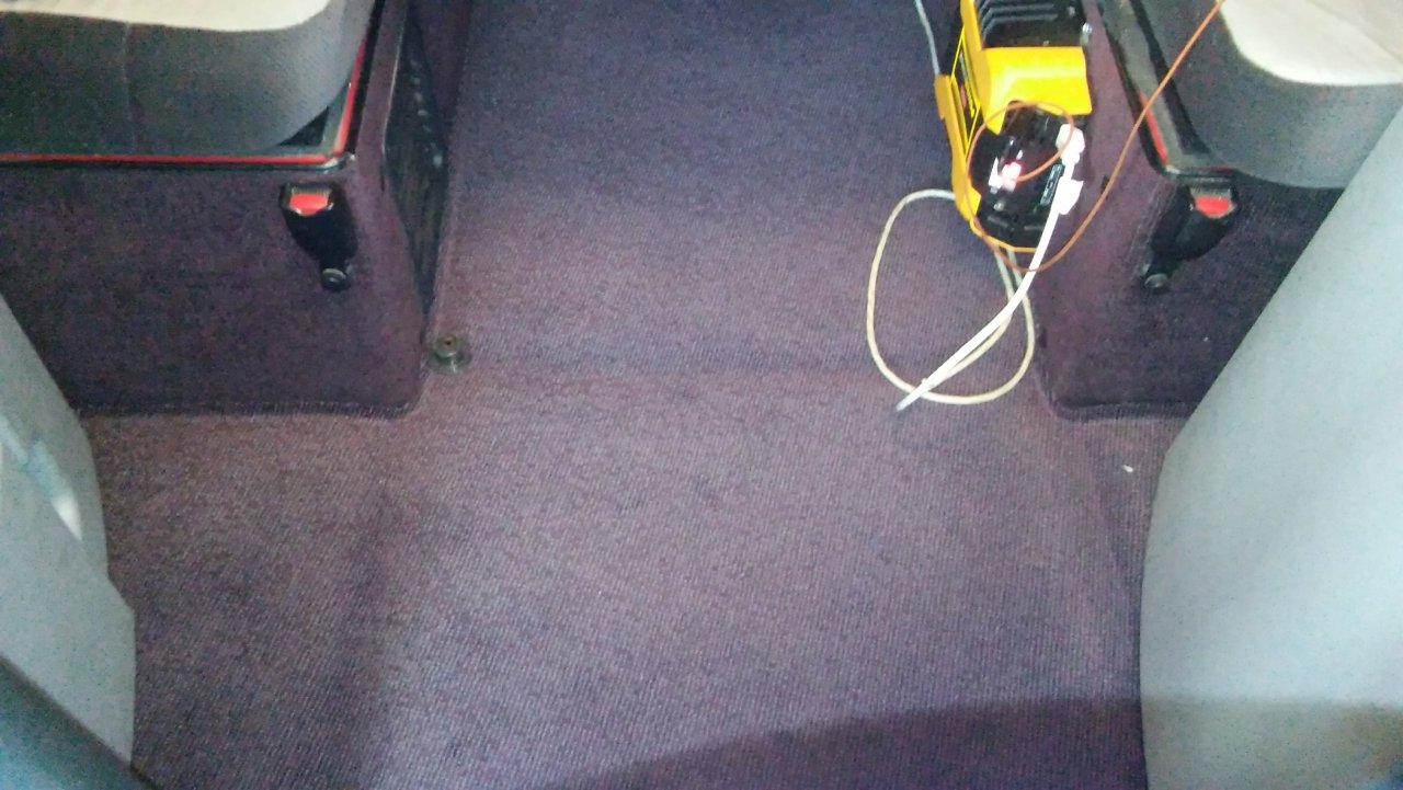

    Hi all. I have new carpet for the sleeper in the 05 780. Looks like a simple install l am wondering if l need to remove cabinets to get this done. Does anyone know if this will need to be done?
    I already replaced the nasty light grey oem front flooring with a new may and it made such a nice difference. I can't wait to get this 10 year old carpet out of here. Thanks!

    If you have the new OEM Carpet you can see if it has cutouts where the cabinets would be if they stayed in place.
    If there aren't any cutouts, then most likely you need to remove the cabinets.

    Thanks we got it done. It is molded and prefitted but we had to make a cut on each side in front of each bench at the rear of each cabinet instead of pulling cabinets out. Can't see the cuts unless you are looking for them.
    Also the hole for the plastic hole cover for the ladder to sit in is not precut or measured. Be sure to measure or what we did was cut out the old carpet where the hole is and used it as a template.
    Beside that it is just a fairly simple job of pulling metal strip at front of sleeper and replacing the carpet. 780 guys l highly recommend this project. It feels like a new truck. This is your home and not only to look and smell better it also is a health issue with the dander and dust built up in 10 year old carpet.
