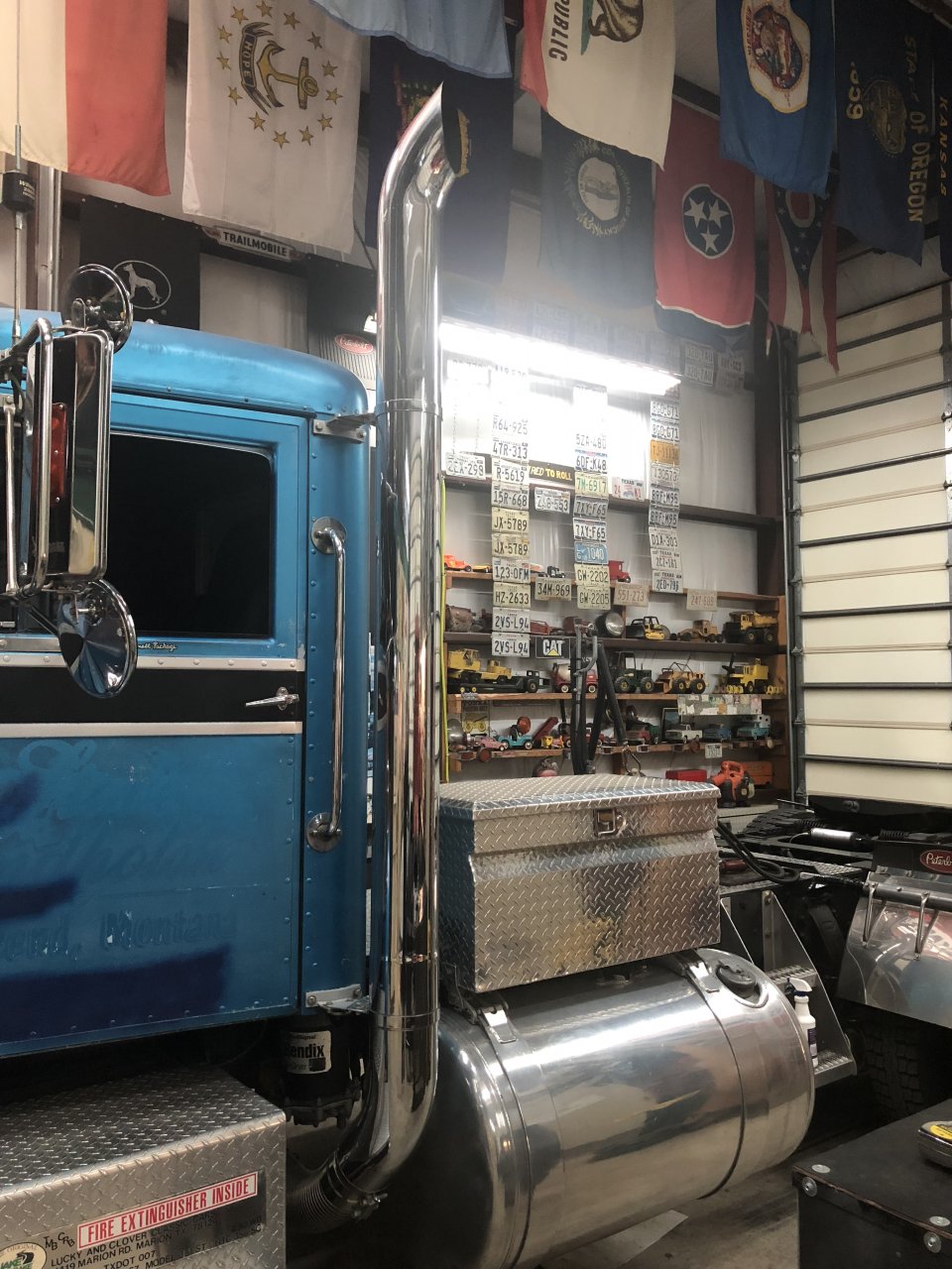

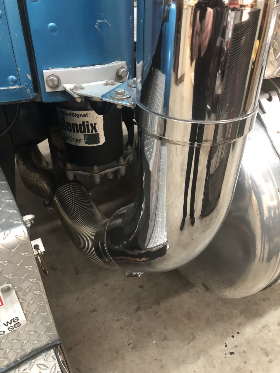

    F0572B4E-DDCB-472E-BD63-FA748ECE29D6.jpeg 366E292C-09AC-4361-BFEE-82CE1E27F490.jpeg I Installed mine in ‘03. Got them at a local chrome shop on I -10 across from Kw and Pete dealers in San Antonio. They are 6” dia. 7’ tall from bottom clamp at elbow to tip of the turn out. Put’s them at 10’-8” tall from ground to tip. So 8’ tall woulda been ok to meet your height goal but we got a lot of old ranches with a lot of trees to deal with. They are one piece 7’ pipe that slip joints over the elbow and the bottom cab clamp holds it together. Easy Peesy. I built the rest of the system from scratch with high qaulity thickwall parts and stainless 5’’ flex pipe from FleetPride.
