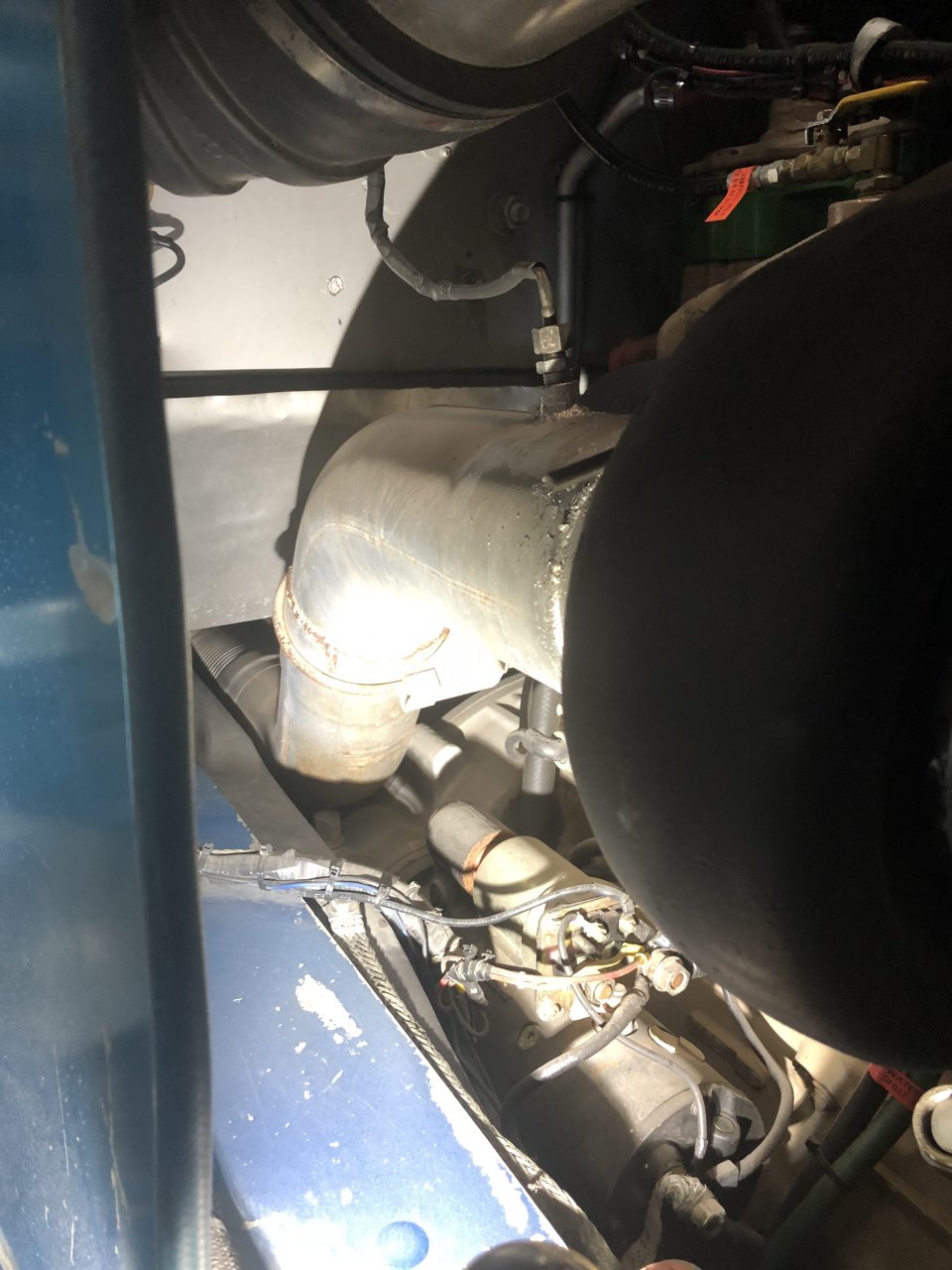

    8B4E85AE-365E-45A0-A8D4-4E069763BC69.jpeg Because the starter is right hand mounted (steering box is inboard on frame on left next to engine block where starter would be) Pete’s had pipe routed over trans and under floor. So I had to custom make all that. Running it at 45’s instead of 90’s really seemed to tune the sound nice.

    mine has the starter on the drivers side its a pretty clear shot down from the turbo. yours looks like it came out really nice.

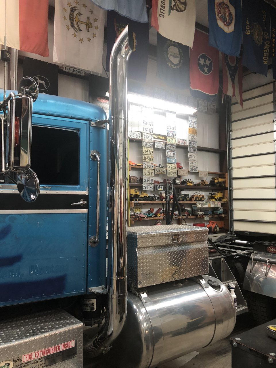

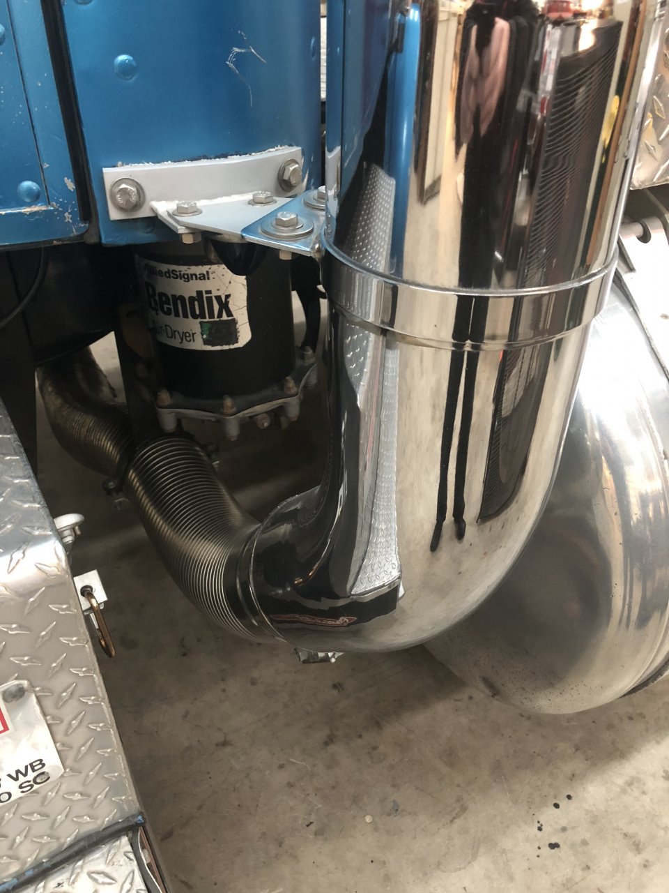

    that does not happen. The mirrors swing out. I run 8" licoln chrome a straight piped. You cut the top stack that slips into the joint at the height you want. I run miters. I also have smoothed heat shrouds that put the diameter at center spool to 9"s I do not lose vision.

    i suppose seems how this got bumped up i did end up going with 8" dynaflex last year
