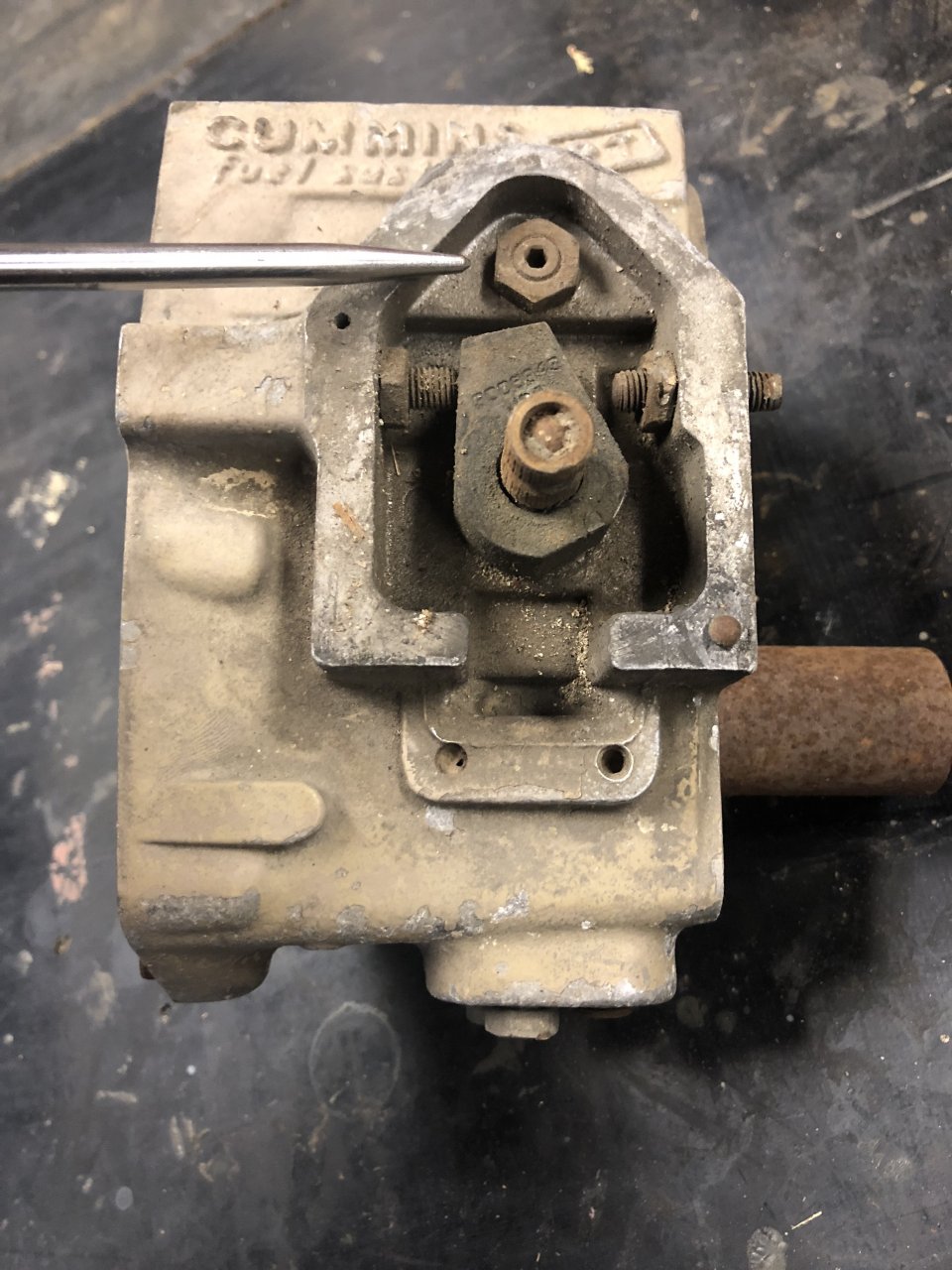

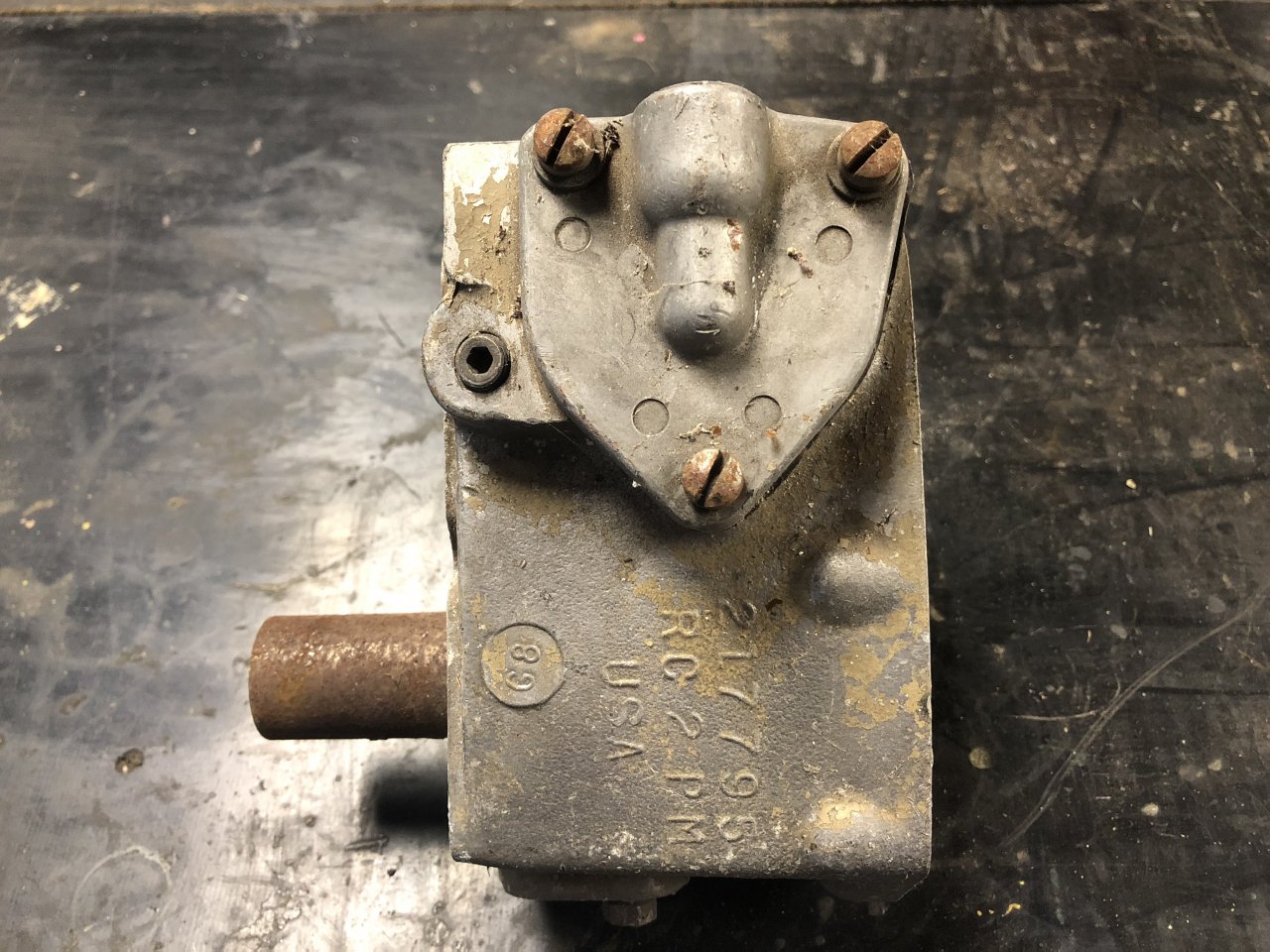

    This is the Afc diaphragm on backside of pump against engine block. A 5/16 or 3/8 hard line goes into it from aftercooler. The rubber diapragm well shrink and leak do to the ULSD fuels used today. image.jpg

    image.jpg The aneroid screw that controls it is here

    This is picture from my pump I never see line from the aftercooler connect at this afc or do I need to be under to see it?
