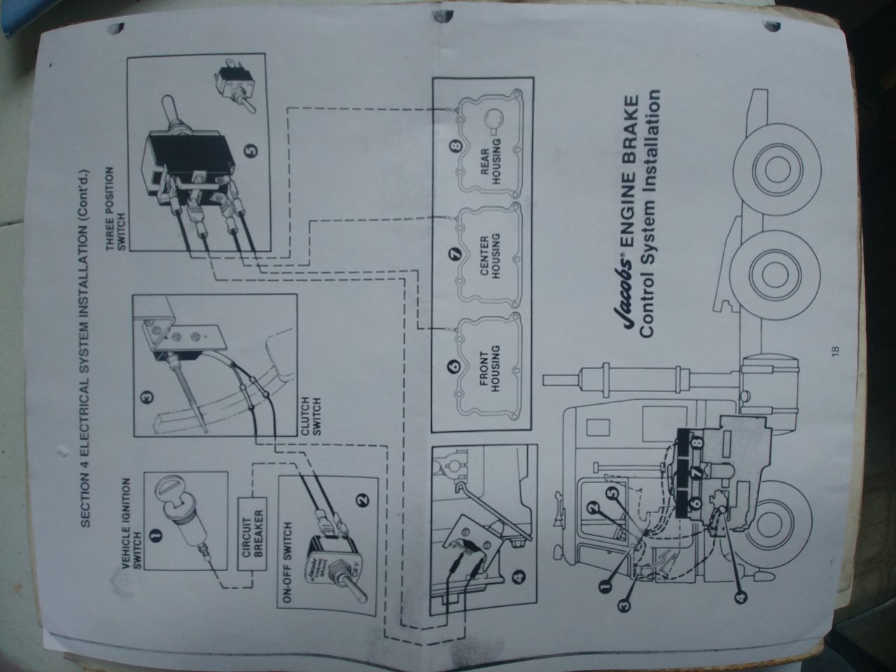

    have u took the vaulve cover off to see if they are hooked up

    Yes. Put new gaskets on a month or so ago and they were then

    May not be. I may try that next. The hot wire coming from the switch goes to the fuel gauge. I thought they needed to go to the ignition but I’m not sure

    There's also a switch on the clutch.You should have power going to the dash switch, if you don't have that you have to trace that wire back to the source, all the switches closed, completes the circuit, gives you the Jake.

    So one thing I noticed is there are 3 jakes. One on each valve cover but where they run to the plug there is only 2. Do 2 of them tie together or is one of the cut wires to one of the jakes?

    Here is a jake brake wiring diagram.
    Follow your wiring and test for electricity beginning at number one.
