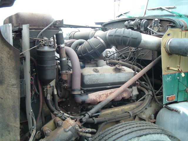

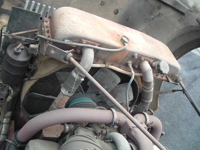

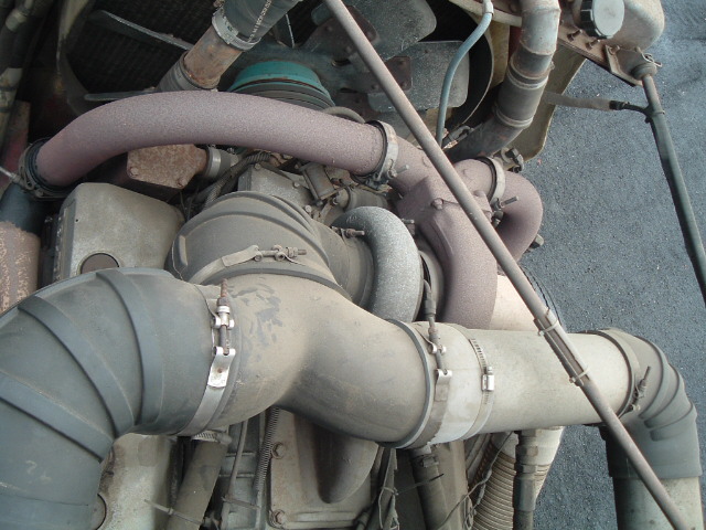

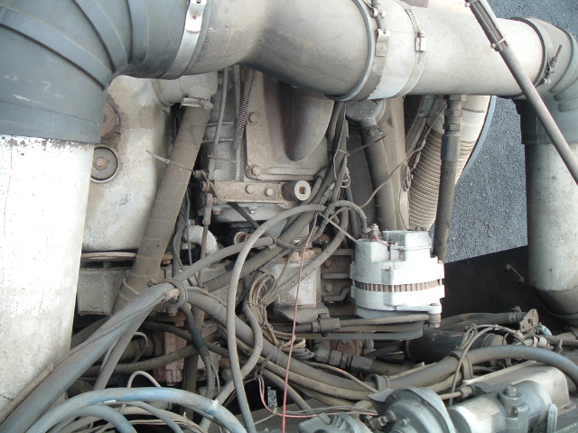

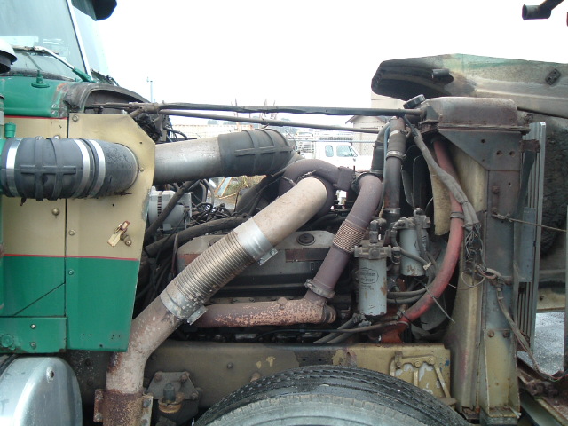

    Here are the pictures of the motor let me know what you all think.
