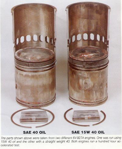

    I'm a big fan of these engines, so I'm biased. Like someone esle said, make sure you run straight 40w oil, Delo 100 or equivalent. The ash content in Delo 400 is too high. These engines require more maintenance than what you may be used to, for exemple, on non-silver 92s such as this, rods and mains should be changed every 250-300,000 miles. Also, do not idle this engine for extended periods of time like you can a Cat or Cummins.

    Not 40w but SAE 40. There are also multigrades (15w40) that work with 2 stroke Detroit but they are very expensive.

    Yea deffently stick with the straight 40 wt and 30 wt oils no mutli grade ils period! The delo 100 would be the best oil for it kinda hard to find but its around and delo 400 is pretty good too. the shell rootella is good but the delo is betta. just take good care of ur 8v92 try too address all the issue when u can soo they dont get worse in time and just keep it well maintanied with the right liquids and filters and such and it'll last for good while. These engine's are alot of fun but very nosiy but if u like noise and somthin that sounds like a race car when shiftin then ull enjoy this engine. The highest rated 8v92 i can think of is the 8v92TTA its 475hp. Ask the old timers about these engines they'll give the scoop and good advice. Ohh and here's a picture of what happens when u use one oil from the other just to give u a idea.
