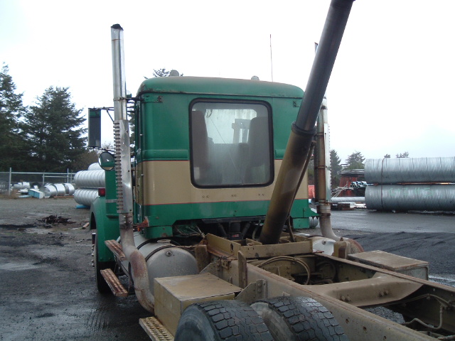

    I would not buy that old of a truck in those conditions, but that is me, I have dump trucks and I put 400 to 600 miles a day, I wish other people will chime in on this, I don't know the conditions of the motor, I'm just judging by a picture and could be wrong, but I hate for you to buy a truck and in a month having to rebuild a motor that is not worth it, like it happened to me, when I least could afford it and that sound like your case, other wise you'll be buying something with a newer engine,I mean even a old Cummins will be better choice than the Detroit, but sound like you getting this truck for almost nothing.
    if you can get the truck to a mechanic and point my worries to em, is the best advice I can give you.

    Their is a shop nearby that is going to do the DOT inspection I can have him look at radiator also & see what he thinks.
    I am getting the truck for $3000 but I dont have money to do a rebuild or a buy another motor. So if the motor is going to blow up I rather not buy it
    Also here are the pics of the truck

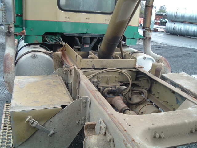

    Truckingman, looking at those pictures it seemed that this truck is not double framed, also the suspension is not heavy duty enough and it makes me wonder if the front axle is rated at 12k lbs and if the brake system has been upgraded which I doubt, can you say here what are you planning to do with the truck, how many miles are you going to put on it weekly, how heavy of loads and what are you going to be hauling with it?
    I'll see if you post back soon I might have a few more questions to guide you on the right direction.
    in other words this truck is very light duty for a dump truck.

    I also notice holes on the frame top side which is not only illegal but and a disaster waiting to happen.

    Those hole could very well be the tapered allen bolts, that hold the cross members in, I forget the proper name of the bolts.

  9. truckingman
    truckingman Guest
    I am planning to use it to haul firewood rounds & split firewood maybe 4 cords 4x4x8
    also I will be only be using the truck a few times a week
    My round trip would be about 70 miles sometimes 160 miles
    if those are holes on the top of the frame rails how do you legally fix them?

    I have no idea how to fix those holes, because your not allowed to weld on the chassis, how heavy is the load intended? if is only a few thousand pounds it will work, but if you plan on loading that box with dirt it will eventually bend and brake the frame.

    There are also supposed to be bolts in the holes where the 5th wheel was, and you are missing both cap rails over the frame. You can see where they were cut off at the hoist. I agree on the holes in the flanges. The truck will do what you are wanting to do, but it would not pass a DOT check the way it is right now.
    Also check the cab. Those style Western Star cabs rust out around the roof clearance lights and the visor brackets. The price is too cheap if everything is good. The engine, trans, and bed should be worth more than that.
