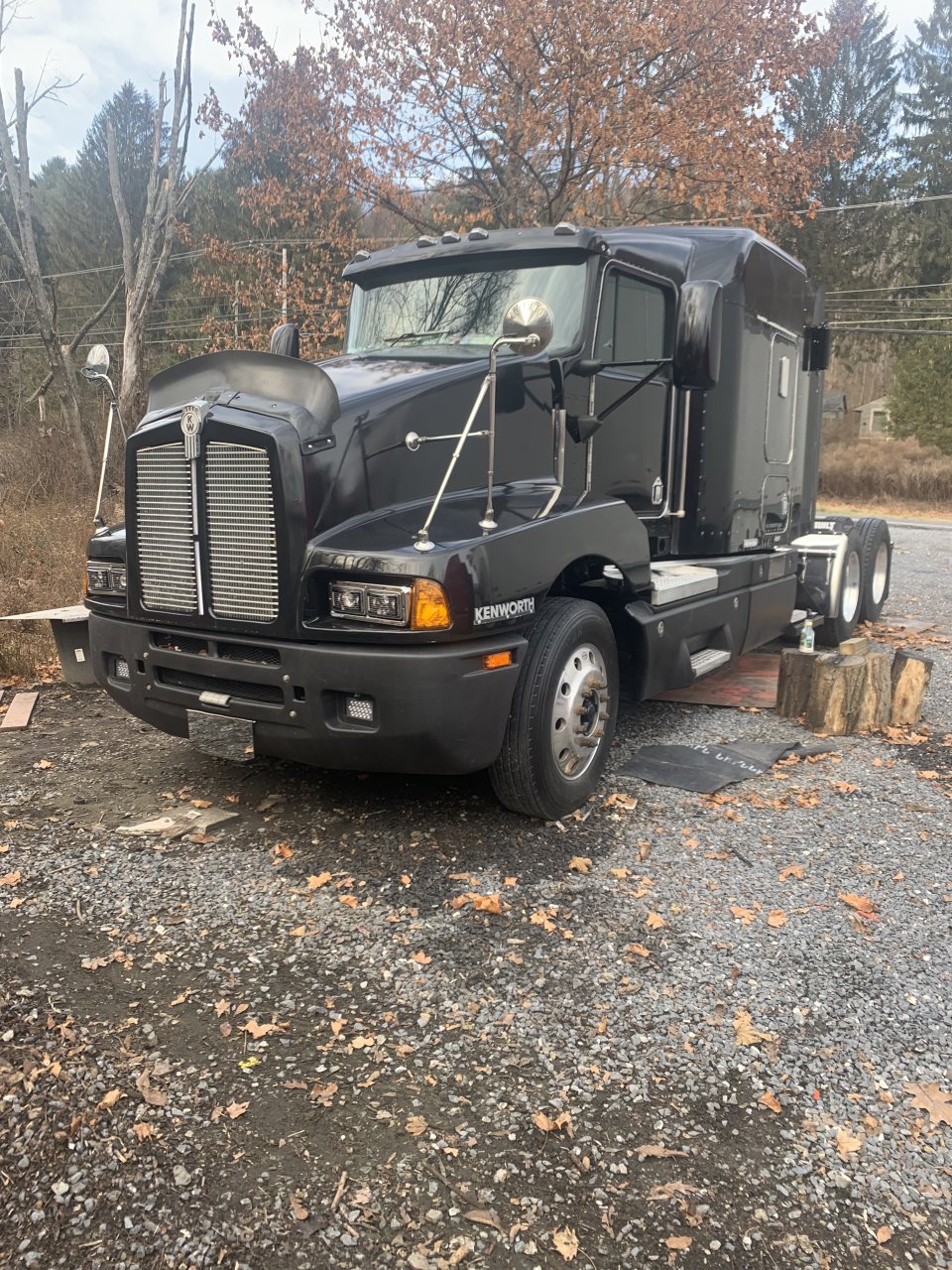

    Fuel tank and side fairing removal
    Remove single driver 150 gal, install new twin 120s
    All new stainless fuel lines bridgestone hose in indianapolis, great job (but $$$$ as hell)
    Pete style step box install
    Properly mount rear sleeper with new bushings/repair/strengthen mount locations
    All new bolts on every spot i removed one (and the new 9 holes i put in the frame)
    Miscellaneous small repairs
    After
    Before
    Cant imagine why i thought i needed to replace the tank hangars 20211129_141646.jpg
    Test fit new hangars
    Previous location of air tanks (mounted to old fuel tank hangars)
    This is a pita setup for how to mount the drivers side battery/step box, had to have custom mirrored brackets made for passenger side and drill that extra top hole on pass side
    Refabrication and frame strengthening of the exhaust support, drivers side, includes rear mounting bracket for batt/step box
    Actual tank hangar install, had to attach straps to top before install cause i can only turn my ratchet 5degrees on the t-bolt in the bracket
    Battery box wired up, not much space and will clean it up some more, but i was able to jam all 4 batteries in there
    Tool thats great even if chinese garbage, couldnt have done it without this.
    Mag drill (in place ready to drill)
  3. skallagrime
    skallagrime Road Train Member
    3,855
    9,929
    Apr 10, 2012
    Indiana
    All in all, an experience, thanks to everyone that gave advice along the way. More to come im sure
