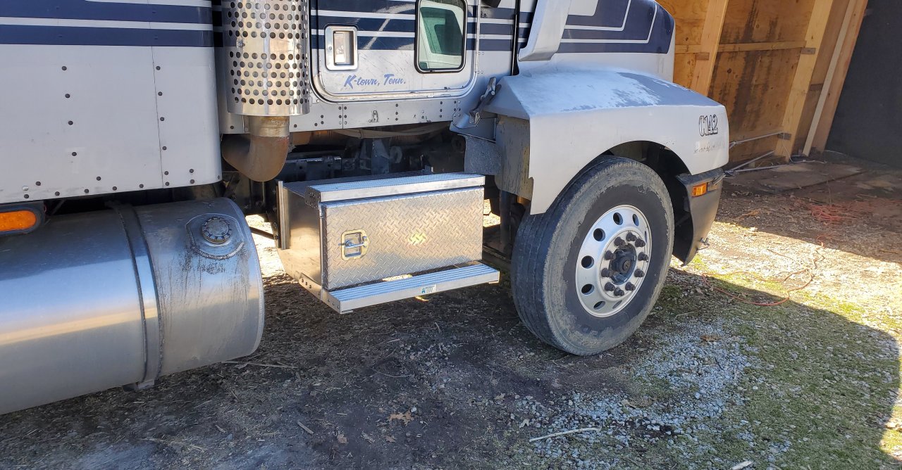

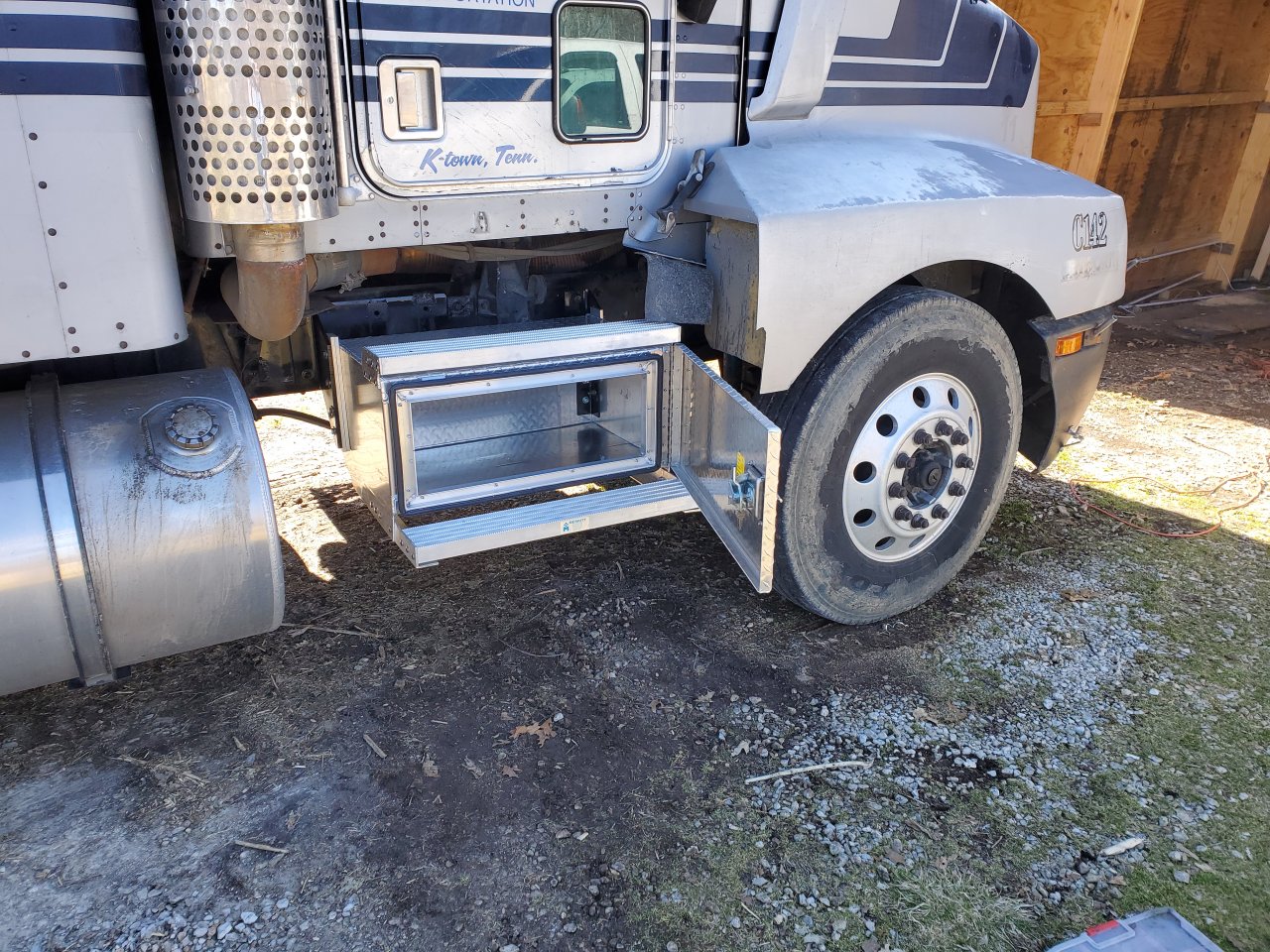

    Finally got passenger side box on

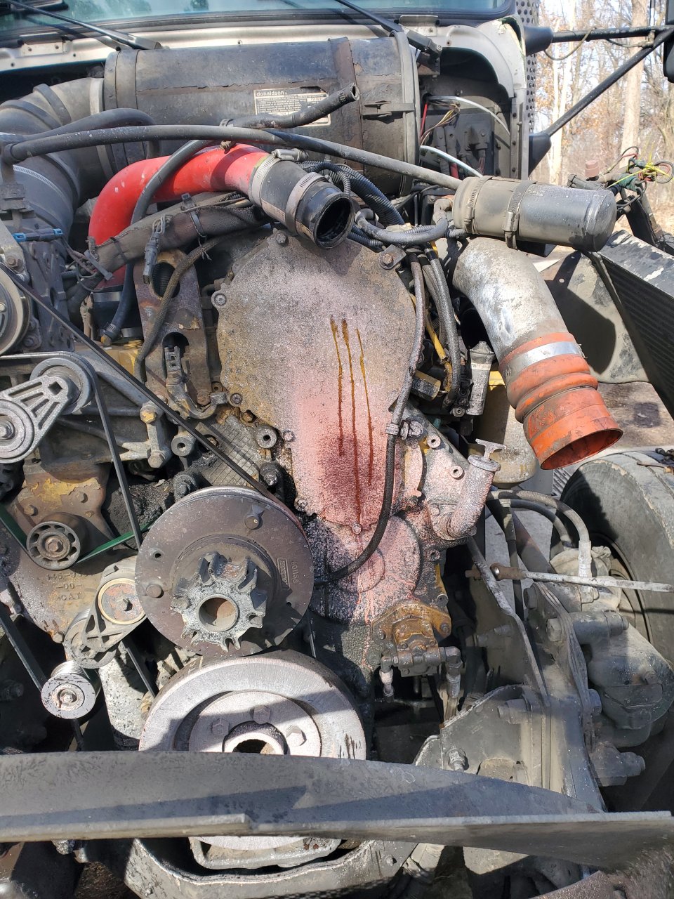

    I know more about hydraulic fittings than i ever wanted to, kenworth is useless for parts, swapped power steer reservoir to the old freightliner style. Those are pipe thread ends on reservoir.... gah
    New power steer pump is clocked 180 degrees from before so big line is on bottom not top.
    Turns out rear seal on the power steer box was leaking but masked by the line on top leaking, so still got stuff to do...
    New fuel pump, lines, fuel filter bases, new power steering lines, pump, reservoir
    And how i got her primed, gotta toss a check-valve on the supply line somewhere, pump simply wont pull from the tank to 1st filter no matter what i did
    Gotta paint better but itll do for now, replaced oil supply line to air compressor, not sure if it was my big oil leak in the front yet, but it certainly was the time to do it

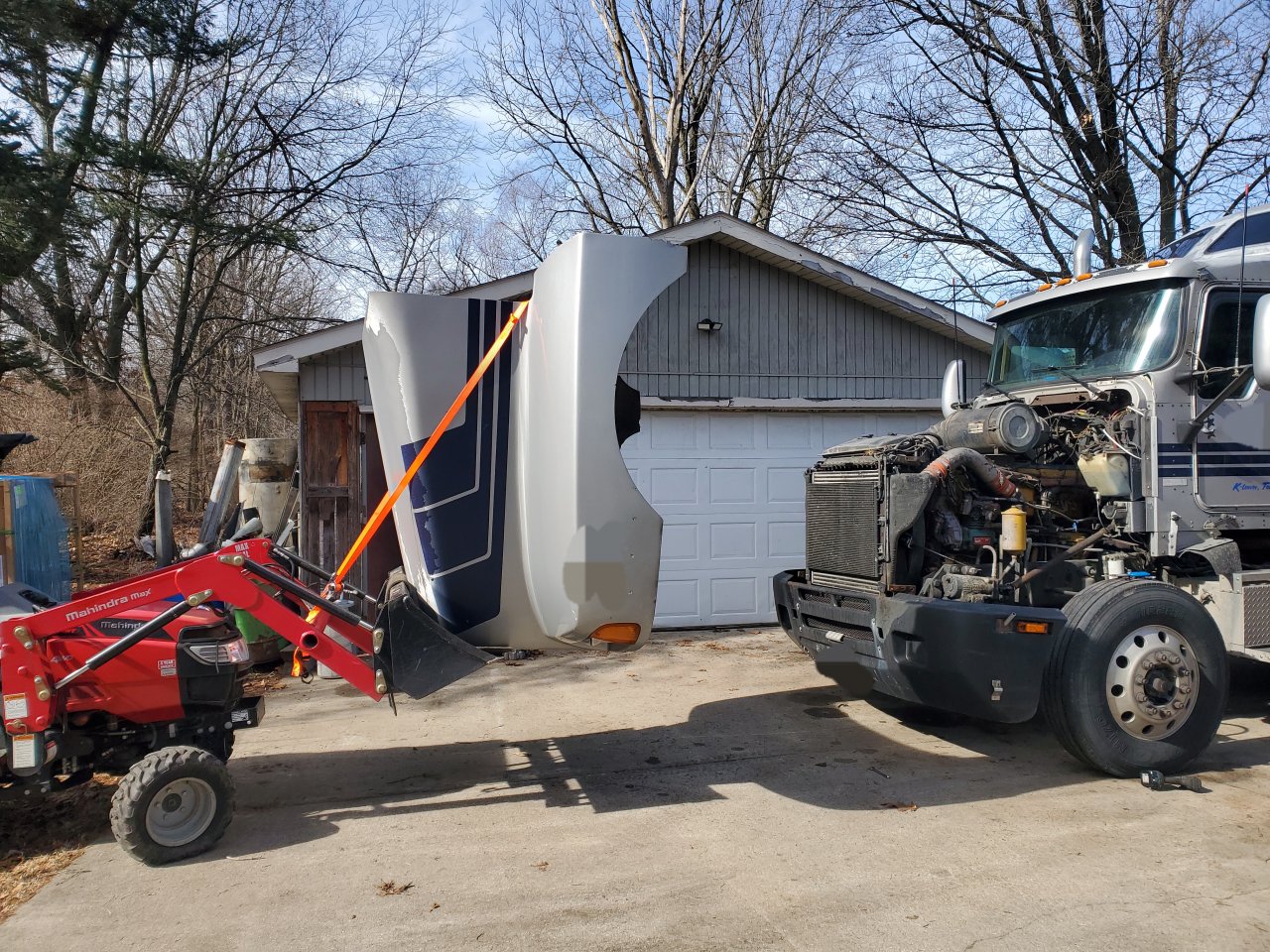

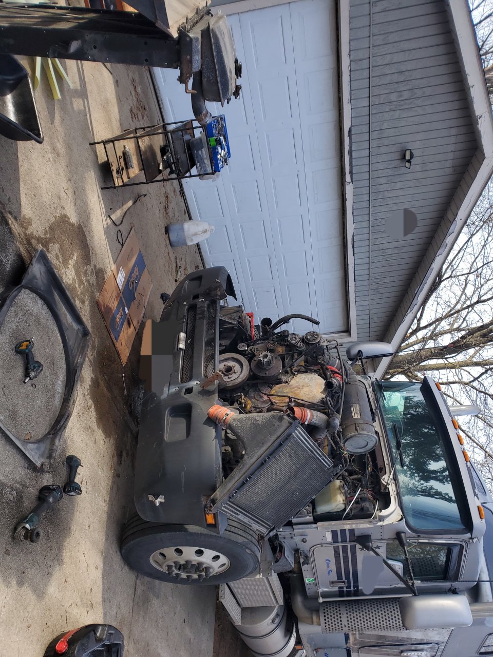

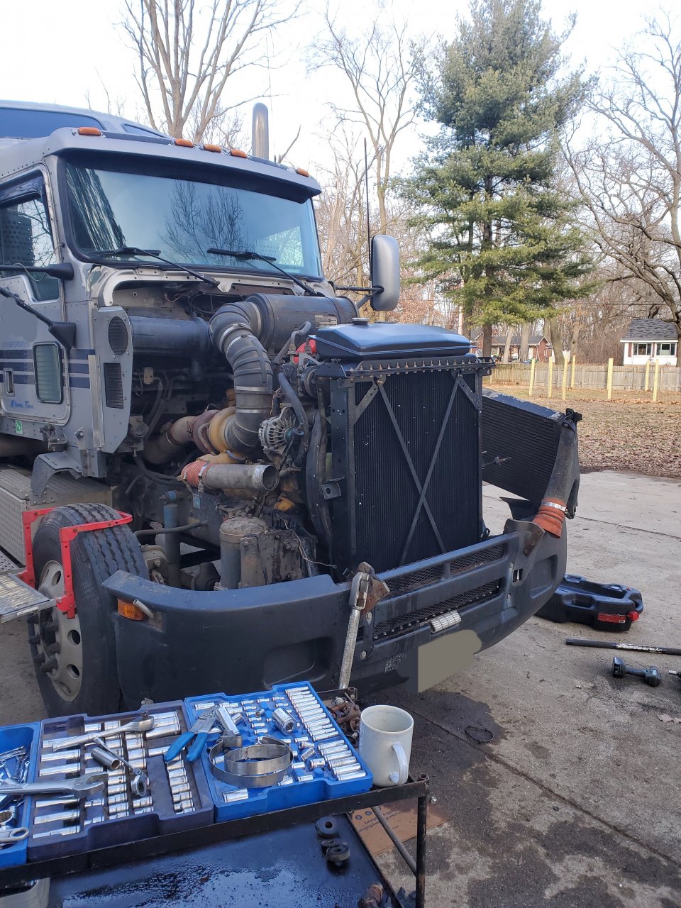

    Remove hood
    Set aside ac/cac
    Remove radiator
    Seems as if i MAY have had a coolant leak
    New radiator in place
    Warmer tomorrow, getting to cold to be outside unless i HAVE TO, and i dont and get my brother as help tomorrow
