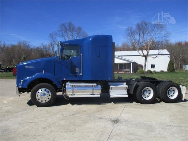

    New to me truck, pickup on monday
    Sons Hero, Tug Toy, Brettj3876 and 7 others Thank this.
  7. skallagrime
    skallagrime Road Train Member
    3,855
    9,929
    Apr 10, 2012
    Indiana
    Its fine, nothing special dealer was asking 25k
    6ts cat with 475 hp. Nearly 0 blowby, ive seen more on a fresh rebuild.
    Supposedly rebuilt 250k/7 years ago, but no paperwork. Was a local home daily truck delivering lumber around evansville. I beleive the rebuild at 250k, but its not worth anything technically since theres no warranty even if i had paperwork
    Rockwell rmx9 (9 speed transmission, .72 final overdrive)
    3.73 rockwell rears
    Interaxle diff lock only, not full lockers
    Low pro 22.5s on alum outers, steel inners, new steers, 50% no-name tires, but should last till june (if not ill just steal my good toyo set of drives from other truck)
    Ac even works, blower not great
    30" "flat roof sleeper"
    Twin 120 gal tanks.
    Terrible paint job, but cant tell till 10 foot away.
    Bunch of annoyances, things i need to fix, change to make me happy, but its probably worth what im paying and can easily pay for itself in less overall downtime within a year (this will be 2nd truck for me, other is running, but needs a few things that i cant/wont do myself, and those things will take time at a shop, this way i can maintain revenue)
