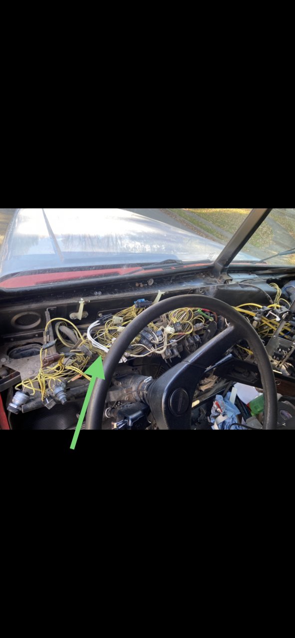

    I have a 98. My tach didn’t work either. It ended up being the harness that plugs into gauge and goes to truck wiring.
    I’m not sure if it’s available separately. I bought the gauge and only needed the harness. Available at Freightliner.
    The white harness in this pic.

    Hot dang that's alot a work to pull the whole dash Joey!!
    Did you replace the skeleton or something.?
    Good too know about that harness. Maybe I'll try one of them.?
    My tach works when it feels like it. Figured I have a bad ground wire or something, but there is no rhyme or reason to it. Can be perfect still idling at 900rpm, & just drops to reading only 4-500rpm. Then goes back to 900 when it feels like it. Also jumps around roll'n down the super slab. But sometimes stays steady on bumpy i80 around Gary, IN.. lol Exhaust note tends to get me by just fine, but be nice if it worked..

    Sorry I missed this. Yes I replaced the dash skeleton and fixed some air leaks.
