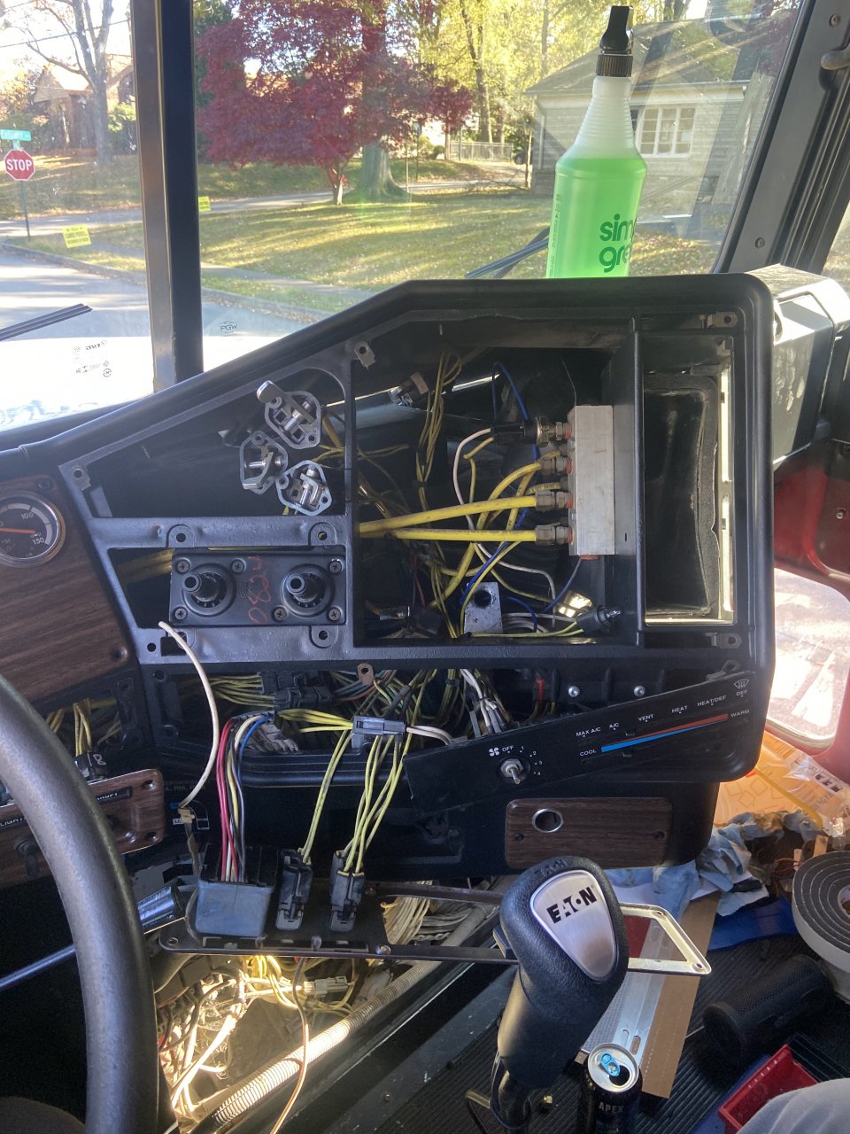

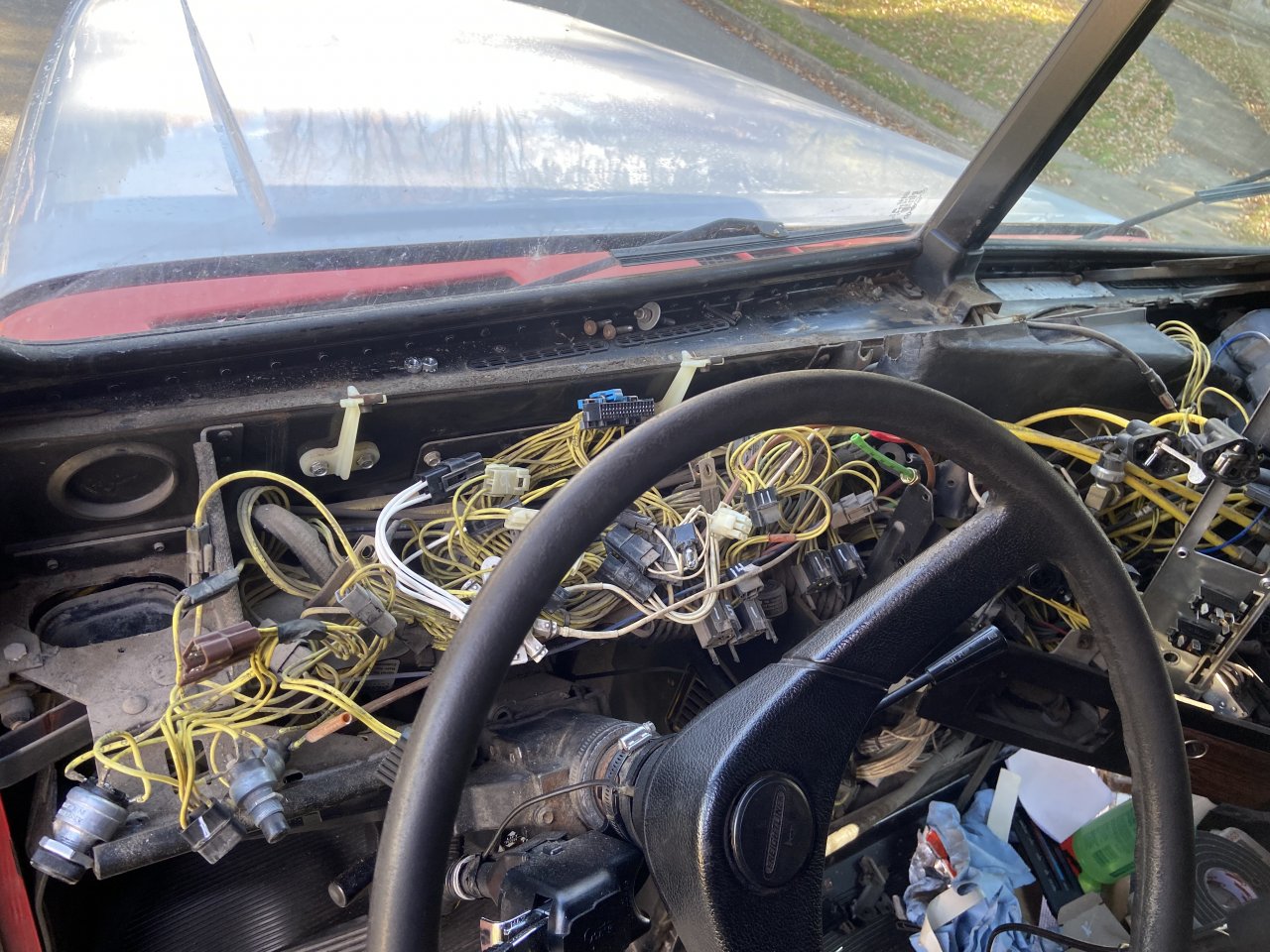

  4. JoeyJunk
    JoeyJunk Road Train Member
    8,762
    68,032
    Dec 31, 2010
    Washington, PA
    My old ones were busted up pretty badly. Replaced dash skeletons, hood, bumper, half fenders, and completely rebuilt doors all in two weeks in front of my house.

  7. JoeyJunk
    8,762
    68,032
    Dec 31, 2010
    Washington, PA
    I just numbered everything with a paint marker on dash end and whatever hooked up to it. Wasn’t easy but wasn’t hard. The parking was left alone. That looked difficult. Luckily it appeared newer so I left it alone.
