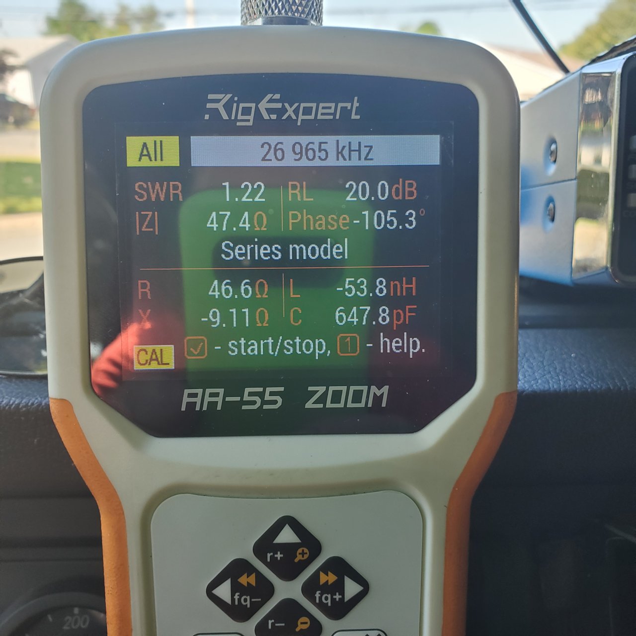

    Ok..Without changeing anything other than brand new 102 and the 6" riser from the ant stud,riser and 102 with end cut off to slip down inside the riser my #'s were almost the same..Maybe a hair better with new set up....
    Older system is the 10"riser with a trimmed slightly 102(more like 101") with a 1" tall stud...New is riser(no stud) and brand new 102...Older is the bottom pic...
  11. craig_sez
    craig_sez Road Train Member
    5,570
    2,714
    Sep 5, 2013
    novascotia,Canada
    Here are new #'s(in above post) with new set up BUT i got power wires overhead,cars on either side and house behind me...How much that will squ the #'s some i have no idea how much....Ill see in abojt 12 hrs when i get to my delivery and an open space..
