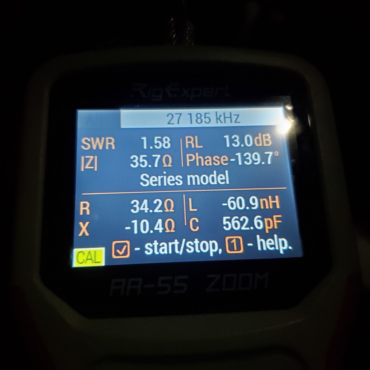

    Well its new coax and has basically same as old coax and some junk coax i have....
    Two pics i just took with stub cal on and off..It basically supposed to eliminate the coax from the equastion..
    Found my dbl male but just cant get the angle for my analyzer to fit on bottom of stud...To late to re adjust ant bracket now so ill have to try another day...
    Ill have to bone up on common mode cause im not exactually shure what it is and how to spot it..

    Just thinkin..Could cmc be caused by running coax and radios pwr/gnd sife by side?
    Pics from my aa55 zoom while on the move....Freakin horrible...

    Last few....With it flexing it goes to hell..I gotta get back to a 10k or a skip shooter...

    That's quite a difference. It would be interesting to see the numbers with the other antennas. Especially while traveling down the highway.

    Well it flexed so much and changes the tune way more than i expected..
    That pvc i do have on it is to wimpy..
