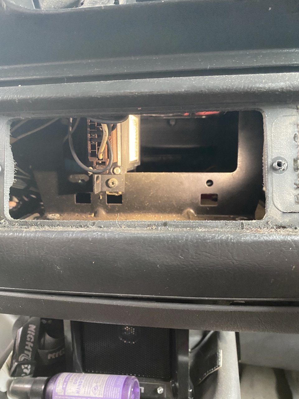

    It's to the right in that brown plastic, right where the picture cuts off.

    Oh, ten 4! I’ll have to go look in just a sec.

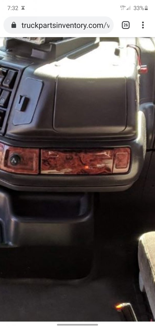

    You might not have it, just like on this pic, then your problem might be somewhere else

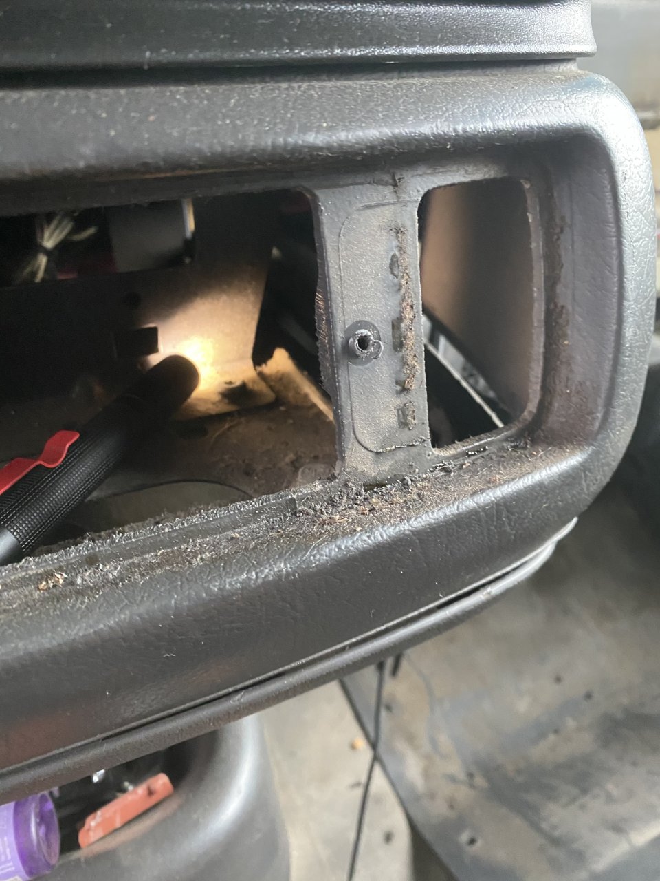

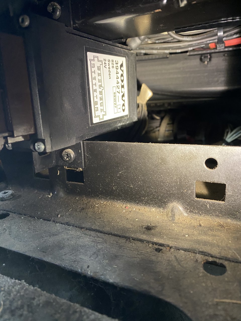

    Ten4. Doesn’t look like I do. I have this big Volvo 24v box, but I doubt that’s it? F6551020-9973-46D9-A32A-C61BE0DB5B83.jpeg 7D3E62C9-E734-404F-B6F4-8BC171877473.jpeg 90F9947D-C8A3-46A6-81C3-2D3213C25197.jpeg

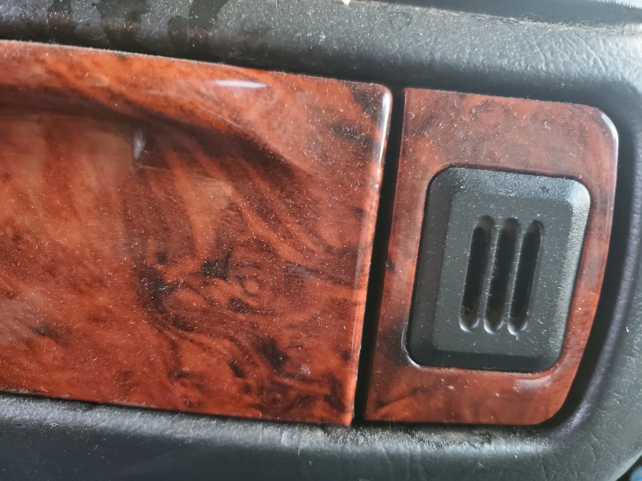

    This is what I have
