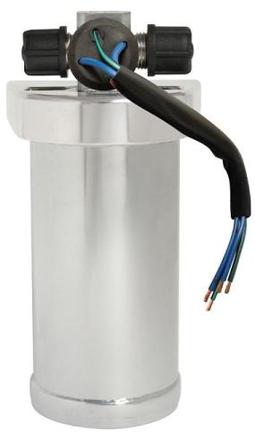

    Anyways, do you have a switch that looks like the picture above on your air dryer?
