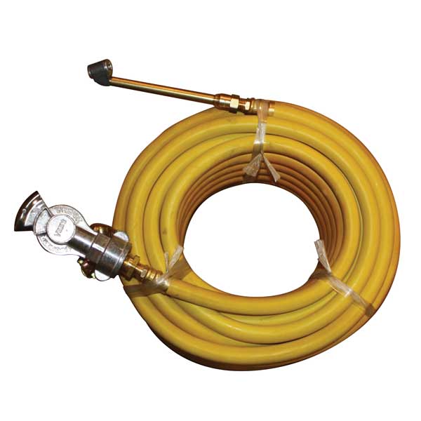

    Many years ago (late 80's) I was one of the first people (in my group) to have one of these. I made it myself. I used to pull RR cans and in the middle of the night in Chicago, I'd pick up a wagon with 1 or more low tires, and I thought, where am I going to find an air compressor around here at this hour. Then it dawned on me, there's one 5 feet in front of me.:smt115
