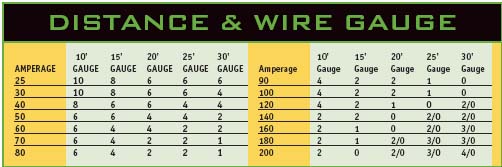

    way too many people think this is rocket science its not....

    more wattage means the radio draws more amps.... period

    you can run a 98v off 8 gauge right off the batteries...it's a 225 watt radio.... now why would you need 6 gauge on a 80 watt radio that's doing 60 watts ???

    that radio does not pull a whole lot of amps. ..barefoot that's 4/sure

    true dat theirs a wire gauge formula for wattage and amp draw ...meaning the maximum amperage draw....

    Yes exactly what i ment..I got ahead of myself when typeing..

    Well i thought it was a bit much for a barefoot radio till i just looked up something..
    12 ga which is what im running now is good for 20 amps
    6 ga is good for 55 amps...
    HHHMMMM just found a watt to amp calculator and put in 80 watts @ 14.2 volts comes out to 5.6 amp draw..A 300 watt will draw 21.1 amps...

    my radio draws about 24 amps on am. 35/40 on side band depending
