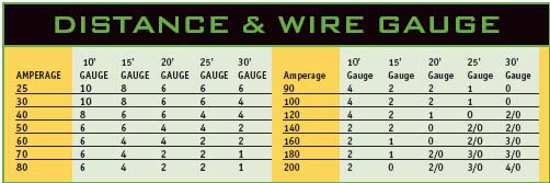

    Just learned by more reading that it also depends on length of that wire to..

    my amp draws 180 amps max. figure that one out.i already know it... something is off on that chart your showing ........

    How long is the power supply wire to amp?? 10 ft or less you need 2ga..1 ga at 15 ft,2/0 at 20 ft..

    it's 0/1 gauge wire/cable its called 1ought correct for the setup ive got and distance wise

    I thought that was the proper term..
    Based on that chart ill need 8 ga for my barefoot stryker..Even then my 955 is only about 15-20 amps..So i could get away with 12 like im runnin now..

    Stryker showed 15 amps with 20 amp fuse but its the length of power wire needed to go from battery to radio that changes the ga size,not so much the amp draw..
