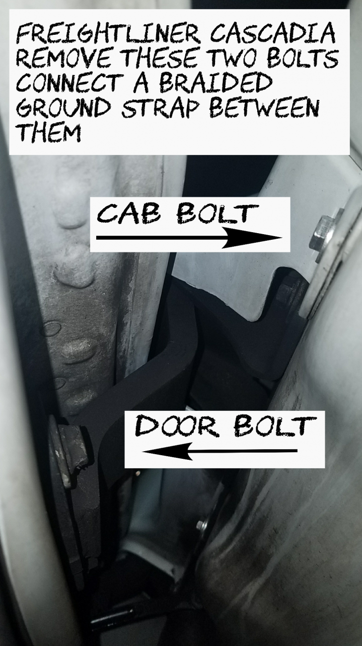

    I actually already have a volt meter (from a community college project way back in the day). I appreciate the picture, rabbi, but I'm not electrically inclined, so I don't understand what you're trying to show me.
    Maybe if you could take a picture of your own strap?

    I ran my ground from the passenger side inside kickpanel, removing the paint at the connection points to the frame of the door. Seemed to have worked fairly well. Also (boredom in Deming NM on a 10 hour break, glad to be back local ) built a raised feed point for the Francis to get it up over the windshield post.

    Man ya gotta do some.reading...
    Ground straps connect two pieces of metal together..In this case its done at the door..I know i posted this and other have as well..Its like your not even freakin tryin....
    Ok..last time..
    Open your drivers door...look at the door hinges....
    Take out 1 bolt..clean the threads and threads where bolt goes..Connect 1 side of strap to door side of hinge..Now do the same on cab side...do noth hinges...Now go look up the term of bonding on k0bg.com

    I don't have an antenna setup on a Freightliner Cascadia but I know someone that does but I don't have a picture of his strap but I do know the top bolt of the hinge on the door was removed and the bolt that holds the cowl to the cab directly across from the hinge on the door was also removed and a 6 inch braided ground strap made the connection from the door to the cab. The hinge is not a good ground because it's lubricated and it moves.
    As the vehicle vibrates your ground potential will fluctuate unless you have a braided ground strap to connect the door to the cab of the truck.

    Thank you, rabbi. I appreciate the detailed response.
