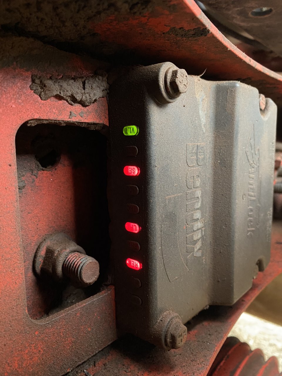

    IMG_1900.jpeg 99 VNL single axle, Cummins M11, Super 10, former Fed-Ex truck now farm cattle and hay hauler. Truck runs and drives fine other than the perpetual electrical gremlins and air leaks. Any idea of where to start to chase this down?
    thanks in advance for the response.
    jay

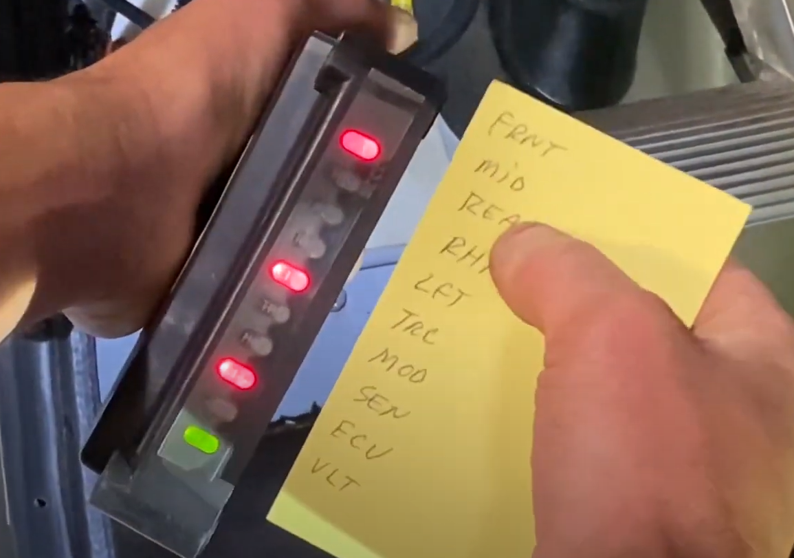

    Well from the video posted above its the Left Rear Sensor If I am reading this right.
  5. Snailexpress
    2,675
    6,068
    Apr 28, 2014
    Rocky
    Yes it's right.
  6. Snailexpress
    2,675
    6,068
    Apr 28, 2014
    Rocky
    Bendix manual Abs Partial Shutdown; Controller Diagnostic Display - BENDIX EC-30 ABS-ATC CONTROLLER Manual [Page 9]
    Could be sensor displaced too far away from tone ring or bad sensor or sensor wire. Or bad wheel hub bearing.

    Refrigerator magnet for the win!!! Ran the magnet down the front of the lights, they blinked a few times, and never came back on. I rant a couple of hundred miles weighing right at 60K last Saturday with no issues. Throw a magnet in your truck guys! Drive safe and thanks again for the responses.
    Jay
