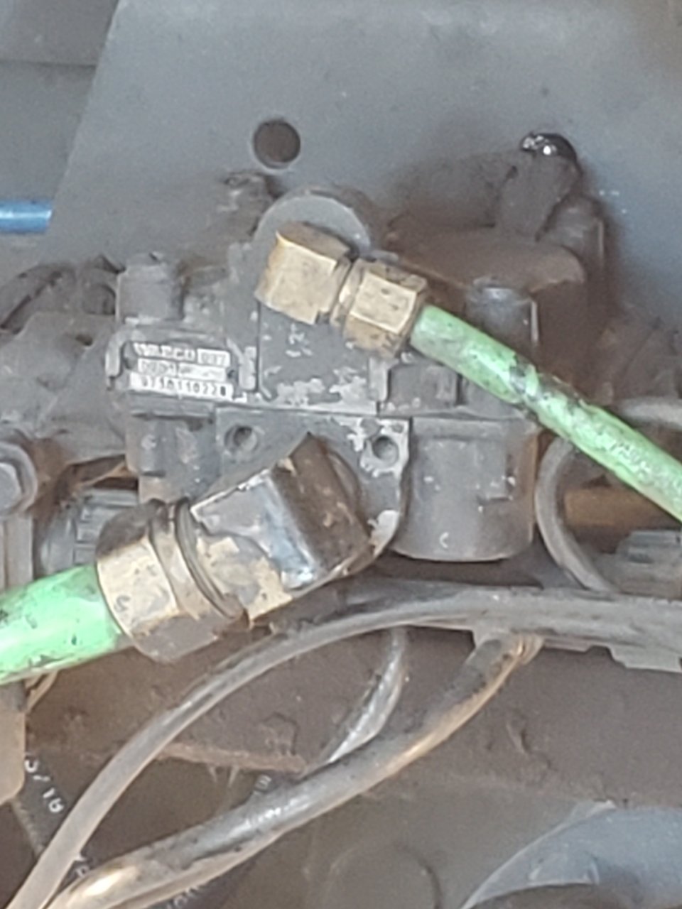

    ok guys 2002 freightliner century my abs modulator under 5th wheel is leaking from bottom and when my yellow valve inside the truck is pushed in it is leaking as well if I apply service breaks leak stops or if I pop the valve off it stops completely any ideas would he appreciated I'm looking my head also what is a maxi pot

    You'll need a new valve. They arent rebuildable. The front one on my international was just over 600 bucks.

    Actually ignore what I said. Check your brake chambers. It seems that one might be leaking internally and that's pushing air back through the abs valve

    Mine was a bad valve. It was @ $100.00 from Freightliner. It’s called a relay valve if its the same one.

    Nope- Its not the same one-
    The one he's talking about is a MONSTER.....About 6 inches by 6 inches by 5 inches thick...Plus it has the Modulator on top.....About 7-8 lines go to it.
    Relay valves are on the Frame generally,or hiding under crossmembers....
    The Valve he's talking about is the biggest one the truck,next to the TPV.

    I miss quoted it is the relay valve that is under the fifth wheel big center valve and 2 smaller ones att ched to it

    two little ones are attached to that one

    The two little ones unbolt from the big one. The big one is about $100.00 at Freightliner. I replaced mine about a month ago. Take the fifth wheel off it makes it much easier. Couple hours at most.

    If it's leaking from the purge valve then you probably have a bad brake chamber
