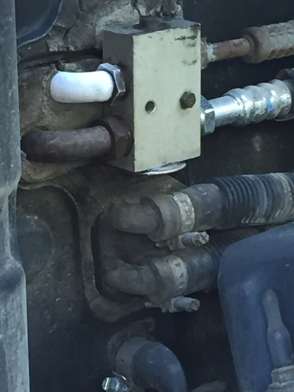

  6. MACK E-6
    50,089
    238,983
    @Cat sdp,
    Are you seeing something like this on your firewall?

  9. Cat sdp
    Cat sdp . .
    21,316
    76,312
    Apr 8, 2012
    Orion's Belt
    Mine is a txv system......
