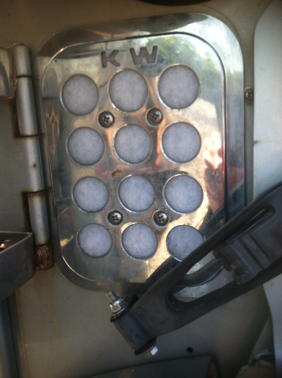

    Air cabin filter, (I believe it's called that). Mine was dirty and works ok after changing.

    KW doesn't really have much of a cabin air filter. Just something that looks like 3M scotchbrite that passes for a filter. I didn't get my truck back yesterday but will today.

    The T600s/T660s/T800s/W900s et. al do, but not all models. T700 has a disposable filter which is installed in front of the windshield on the passenger side. T680 (and I believe the T880, as well) use two disposable filters - one thin and one thick one - which are particularly prone to getting clogged up. Plus, several models also have an additional mesh filter in the MVAC compartment which is generally expected to not require maintenance/replacement, but often does.

    T-800 Fred Flintstone cabin air filter.....
    New filter just helps air flow.....

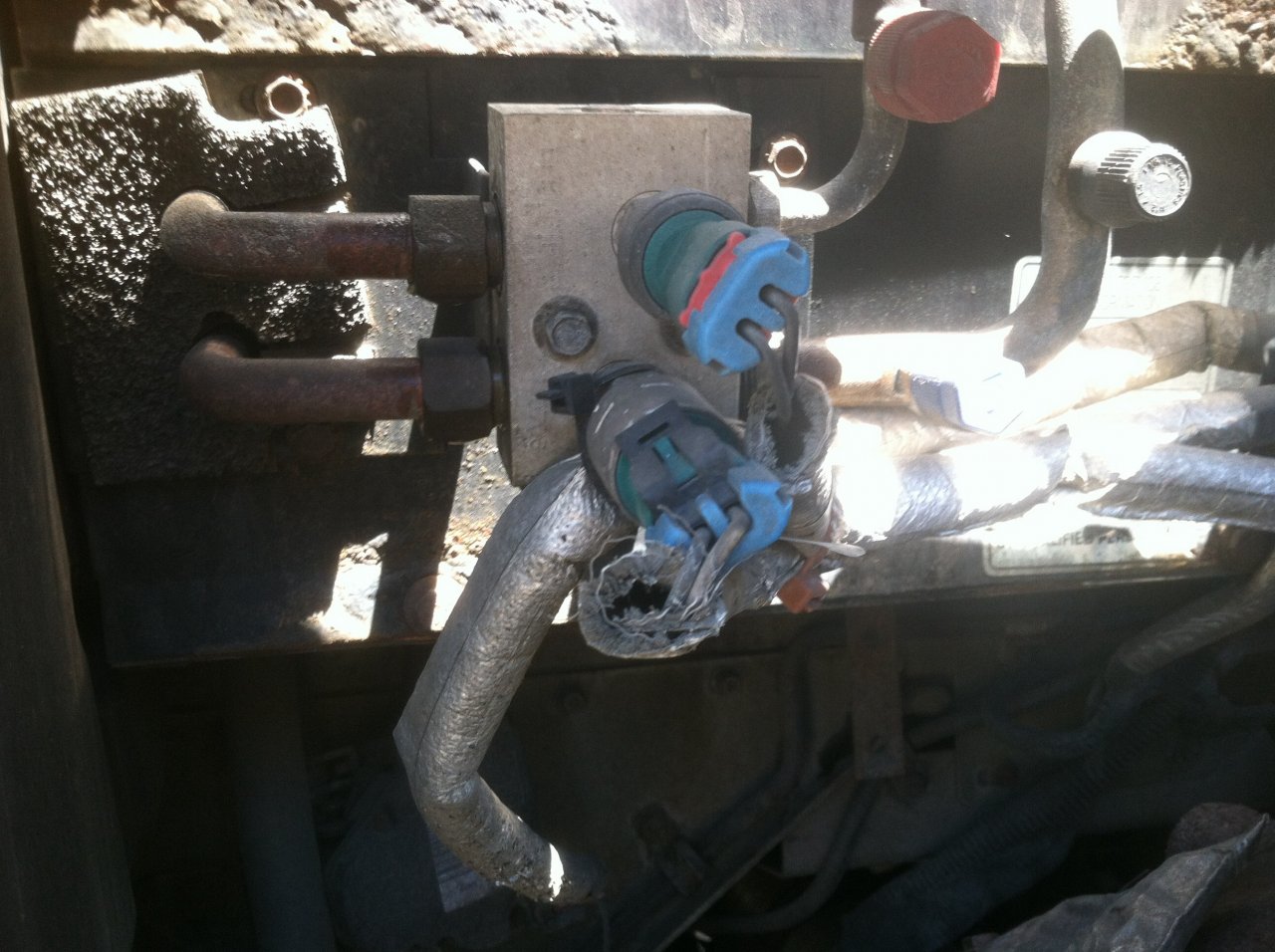

    So I basically demanded that somthing be done....
    So we're changing the pressure regulator (I think that's what he called it) ....
    This
    And a new dryer..... We always do things right the second time...:)
