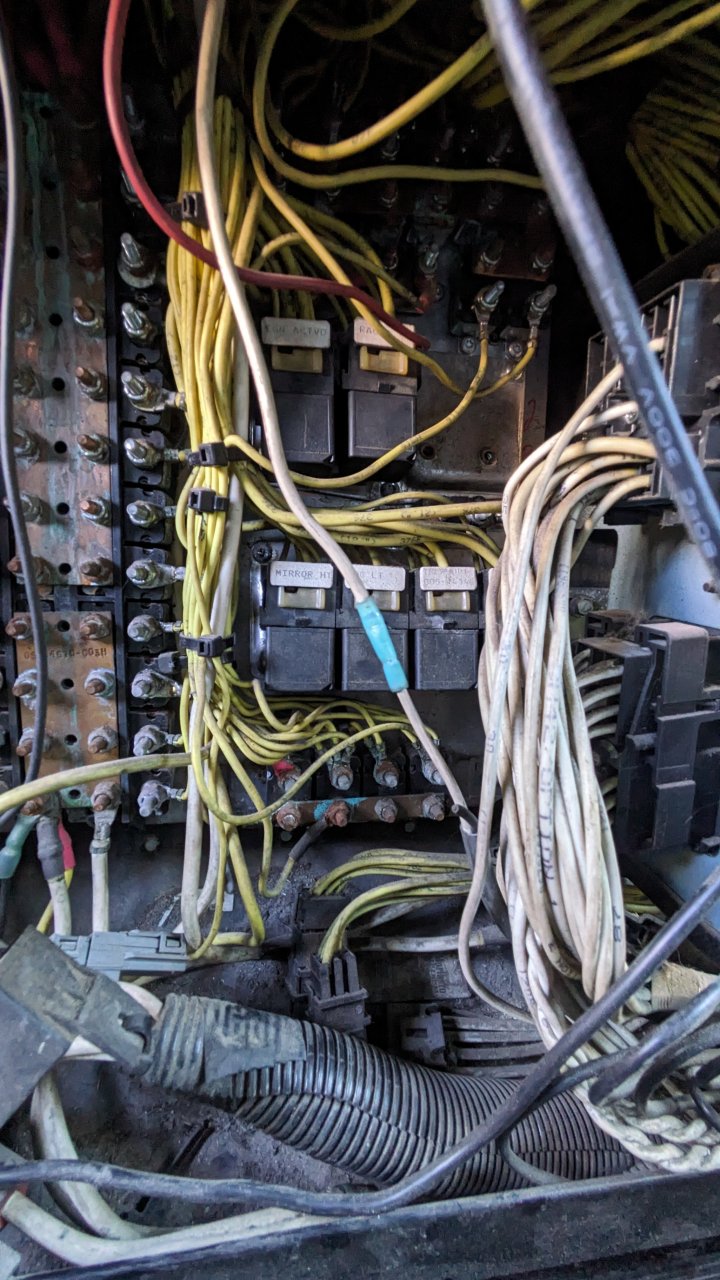

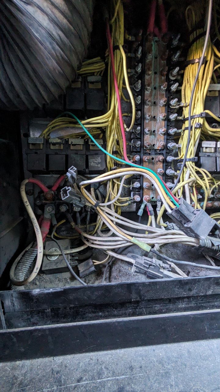

    Okay both clutches are right at 3 ohms so that is fine. According to my diagnostics both wires do have power but one is supposed to feed back to ground in the fuse box and currently isn't. My fuse panel is missing basically every label. I did find the AC power and AC clutch power and cleaned them up no issues there. Any idea where the ground would be? I also think I know which one is the ac relay based on photos I found online. Haven't tested it yet. Wanted to find the ground first.
    PXL_20240601_175509423.MP.jpg PXL_20240601_175513206.jpg PXL_20240601_175519174.MP.jpg
