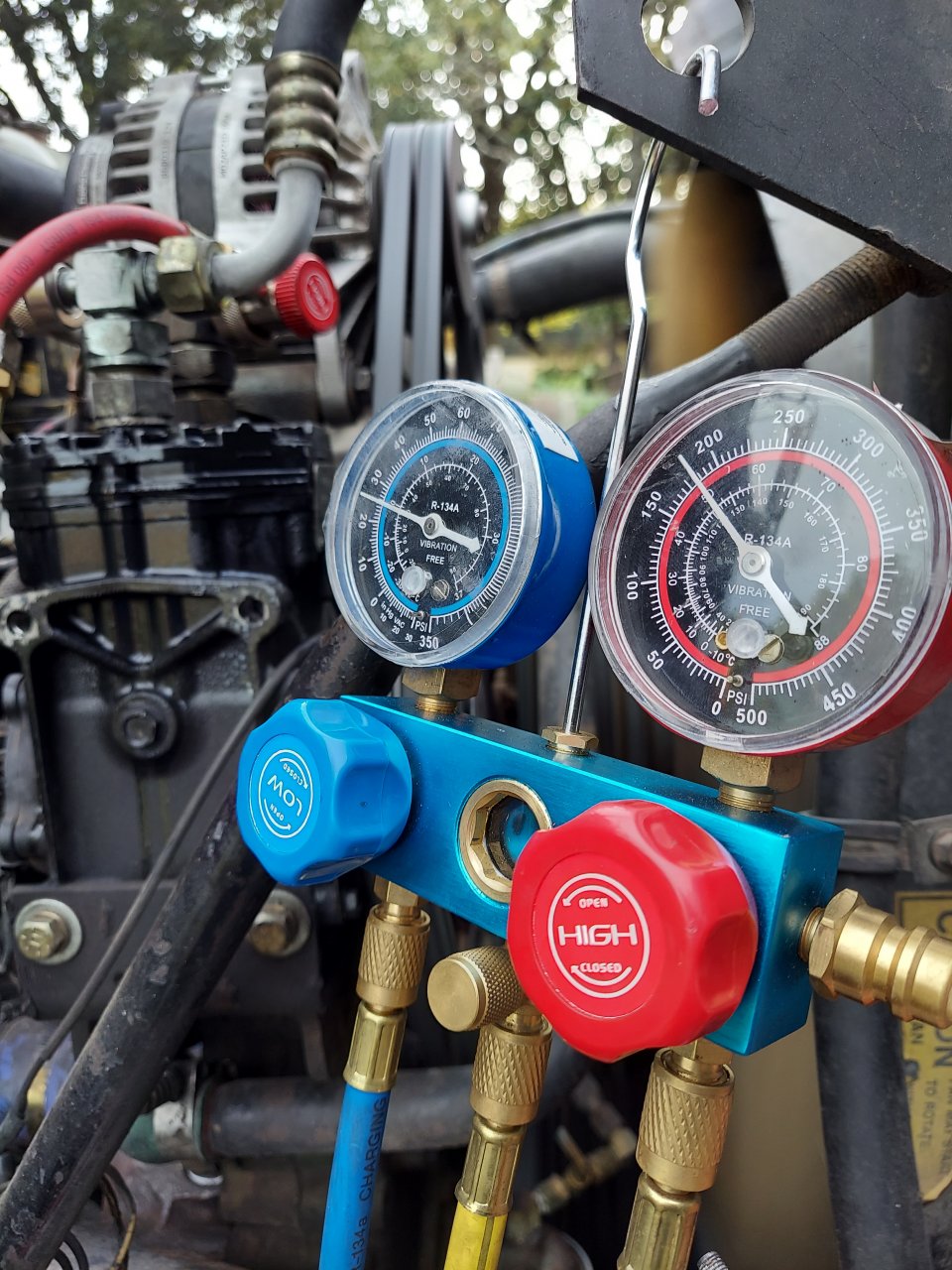

    Don't worry about the weight, obviously that scale isn't accurate. I'm charging mine as we speak . Low 80's, low humidity. How much weight, I don't know. You can see it's still a bit low. 20210924_172403.jpg

    Now you can see head pressure has risen only 5psi, low side hasn't changed, even though I added freon, but the A/C compressor is thawing out. We're very close 20210924_173254.jpg
