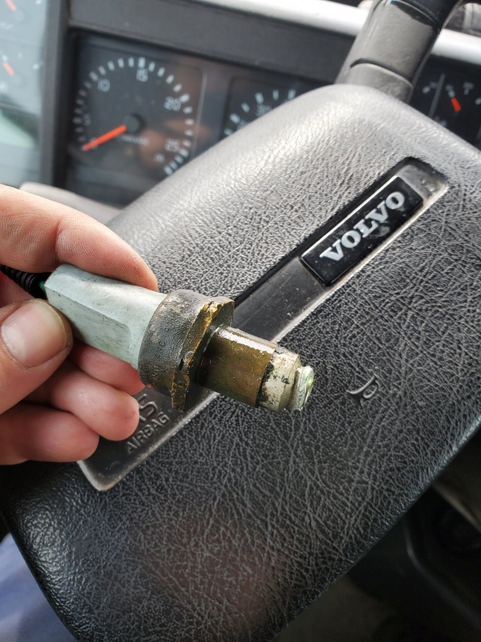

    AC Compressor only works for a few seconds after starting the truck, then shuts off. Thought it's a bad compressor, put a new one, nothing has changed.
    Freon is good, recharged, no leaks, everything is good, did it already like five times. Changed the Apad AC module, new temp sensor behind the fan blower, change high side ac sensor. Nothing helps.
    It's a 2003 Volvo with older style AC control in the cab.
    Where else can I look?

    Low side pressure sensor is what kicks the compressor on.

    Ive had to replace the pigtail that plugs into the pressure switch before, same issue.

    CK all the plug in conn. on hi and low sensors for cancer on them from road spray?

    check pigtail going to the a/c dryer. Had a few that have corroded out or just worked loose

    Thank you everyone. Will update after replacing the AC pipe and installing new low switch.

    Changed the low pressure sensor, compressor engaged for a minute, stopped, engaged and then stopped again. Does not want to work again.
    Gotta find an AC specialist I guess. The shop I did the repairs at, don't know what can be wrong
