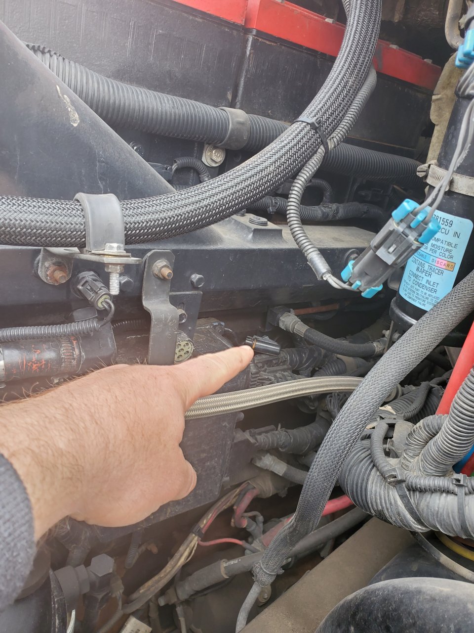

    Update: after $800 in parts, I removed the ECM fuse and even though it looked good, I replaced it with new. AC now works. Go figure
    This is N14 engine and here is where that fuse is located, in that little plastic box

  3. 062
    062 Road Train Member
    6,352
    34,037
    Oct 20, 2013
    Does that fuse go to ground? If it does, I’d run another from the frame to the motor.
