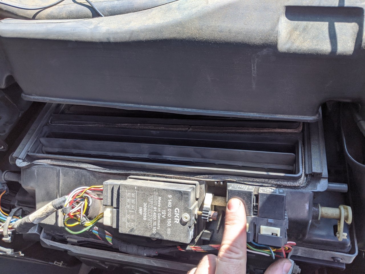

    So last week on the way home I stop at Volvo in Toledo, get a new expansion valve and was going to get that relay, but two different part guys could not find anything and claimed that there are no relays in there.
    Ok, I went home, dropped off truck at a shop and told them to also replace that hot/cold valve, since I had one laying around for ages.
    Later that evening I picked up the truck, AC was working and I was happy as hell.
    Today I went to my yard to work on my car, started the truck, turned on the AC just to make sure again that it works fine and started to do other things.
    Well, came back to the truck 20 minutes later and #### thing is not working again! I wanted to pull my hair out.

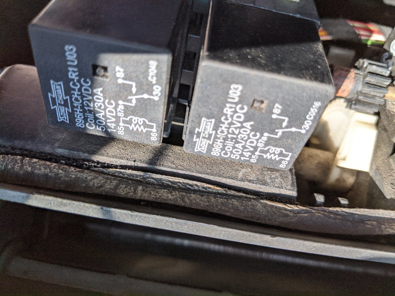

    Figured to check on that relay, thank you for pointing that there is a bolt under the speaker, I would have never thought of it. Took the panel out, there are two relays in there! I don't know why dealership could not find them in their schematics.
    Switched them from left to right and the #### AC started to work!!!

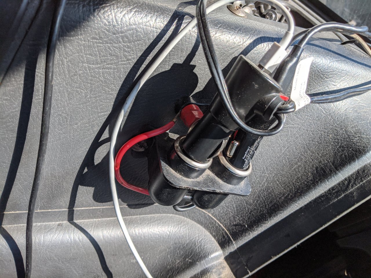

    The easy way to check if relay is bad, switch them from left to right. The right relay is connected to the CB radio power, where people usually connect their phone chargers. I plugged my phone and it started to change intermittently, second on, second off.
    Thank you, @nasriza ! Not too many people know these older Volvos and you just saved me from losing my mind!
