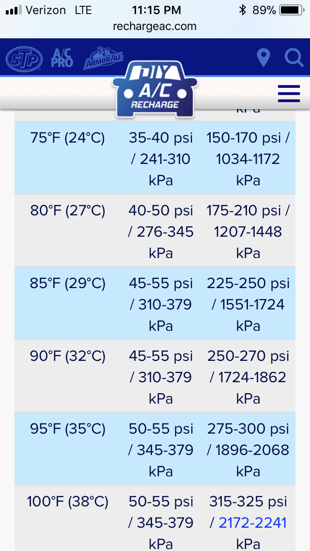

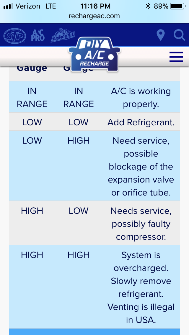

  10. truckdriver31
    6,998
    8,363
    Sep 18, 2013
    7F82BAE6-3D96-4514-A2C1-E590CAFC33C7.png 17FD13B9-8531-4F7C-8FC7-A9440535EECF.png
    gauge it
    Rideandrepair Thanks this.
  11. truckdriver31
    6,998
    8,363
    Sep 18, 2013
    put paper clip in the plug. see if it comes on. but truly need to gauge it
