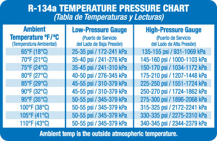

    815F5171-2374-449C-9A9C-6173F6128B32.jpeg its just a reference tool.
    PermanentTourist Thanks this.
